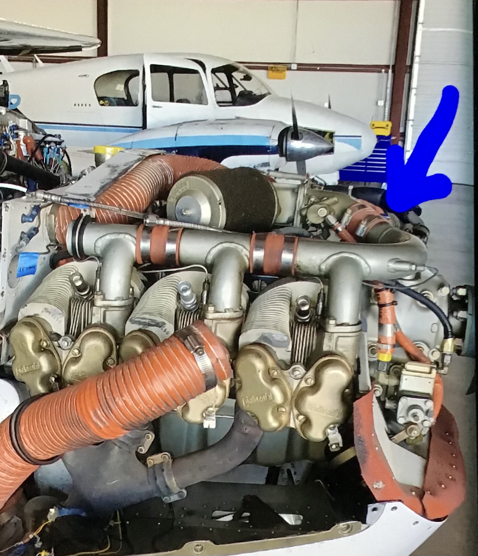

I have an EI MVP50-P on the front engine that was reading some impossibly high number on the Manifold Pressure (1400Hg instead of about 21Hg). EI said to check the Manifold Pressure sensor and connections to see if it was malfunctioning, which I thought would be on the intake manifold after the air filter. I could not find the sensor location. Can someone tell me where the MP sensor would be on an IO-360? Is it in some unexpected place?

On my air-breathing G model, I used the MP port on the forward induction plenum (the Y after the air filter) when I put in my GI275 EIS. See pic, blue arrow points to port location. You may also need to check MP plumbing where it passes thru engine baffle at right rear behind cyl #1.

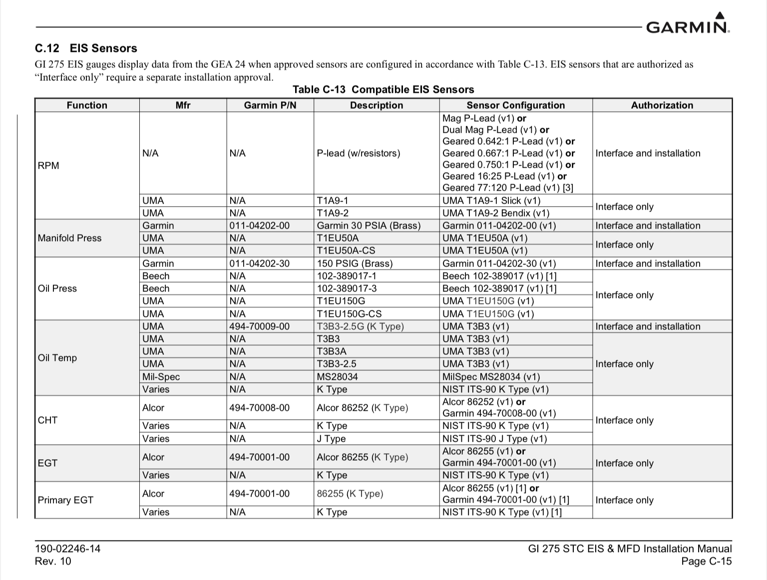

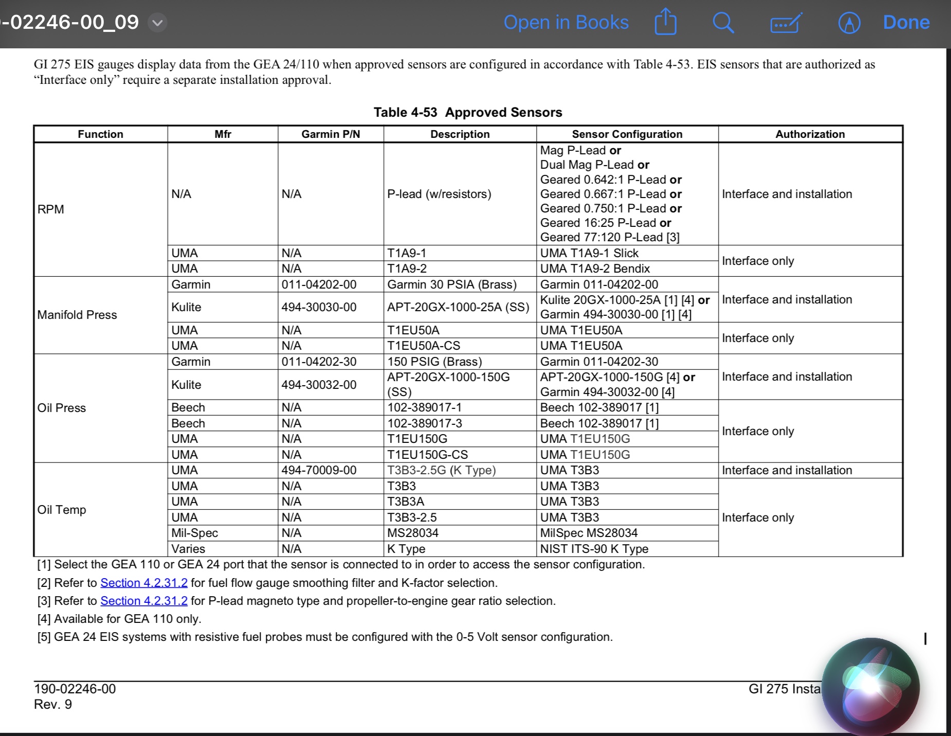

I am looking into getting a pair of GI275 EIS's... quick question about the MP sensors... Yours were ok out of the box since your plane is NA? I have turbos on mine and my MP gauge redlines at 37in with a top of 40"... garmin only has a 30" sensor....I cant find one to go as high as 40"....I know I will never see that but I do redline on TO.
There are multiple sensors listed in the EIS install manual, see attached pages. I used a variety of sensors, some from a 6cyl g3x sensor kit and some from third party sellers. If the sensor is on these pages, it’ll work with gi-275 EIS.

I think that "Garmin 30" manifold pressure sensor is actually 30 PSIA rather than inches of mercury. If so, that would be approximately 61 inches of mercury and it should be sufficient for our turbos.
