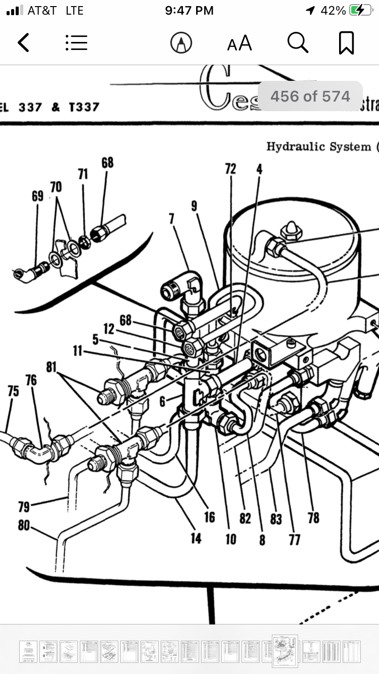

Unread 11-05-22, 10:54 PM
Looks like the fill tube goes to the bottom of the reservoir. If so, missing that nut leaves tube open to a high pressure area from ram air. Can pressurize reservoir and possibly even bubbles the fluid introducing air or even foaming.
See attached link
Tube #68
