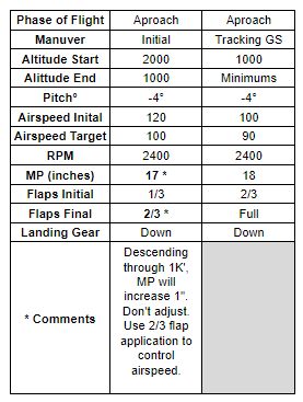

I'm working with a guy now, checking him out in the Skymaster. He is already a ME guy but has been flying SE airplanes for several decades. During that period, he has been light on instrument flying, and the goal is to be very proficient in flying the 337 in VMC or IMC. I fly with power and pitch, and the attached table works really well for getting down to the runway without goofing around out on the approach. It doesn't matter whether the airplane is being hand flown or flown by the autopilot. Everything is very smooth.
