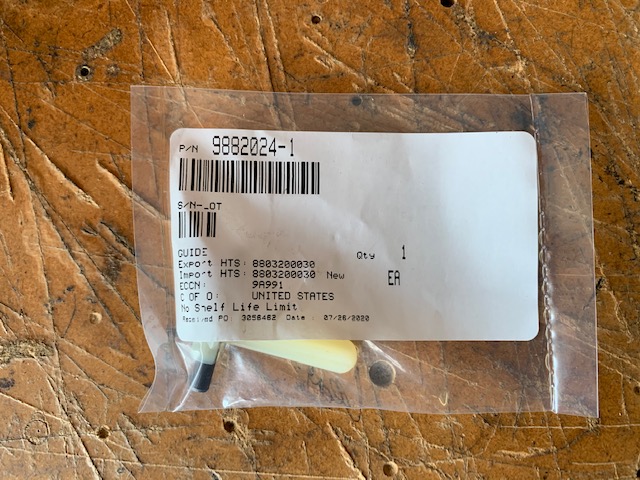

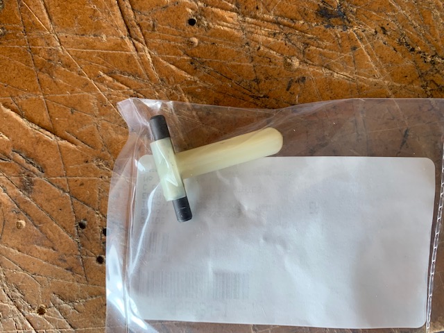

Unread 10-18-20, 01:31 PM
Pin Picture
Just so everyone is aware, the new (replacement pin) still has plastic, so you really have to look close before you go pulling this out if you see some white plastic. I have included photos of the new replacement pin - note the guide is still plastic.
Mark, it is not difficult to replace this, but it does involve removing the actuator and downlock. It is not tricky to rig on install, but takes some patience and is a tight area. You want to rig it perfectly too, on install.
