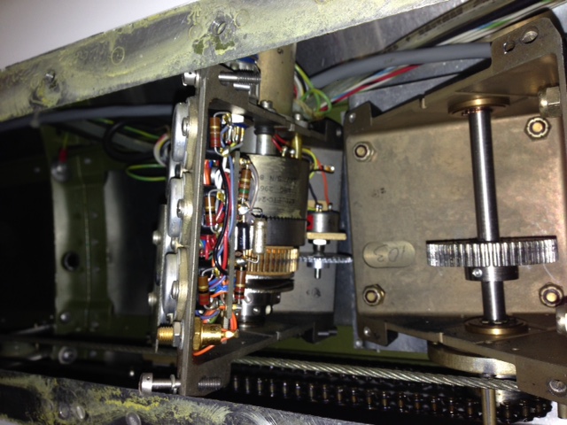

Unread 02-11-16, 10:50 PM
Elevator actuator split for centering system
