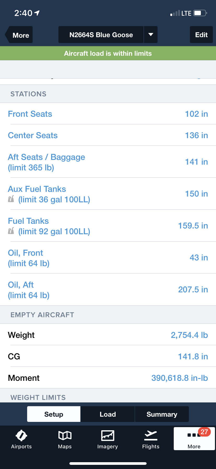

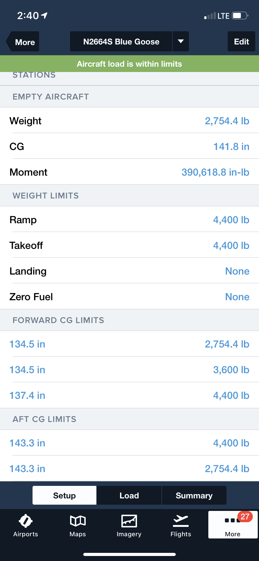

Could you post on here a snap shot of your w&b

Here’s my entries in ForeFlight for my ‘68 n/a
