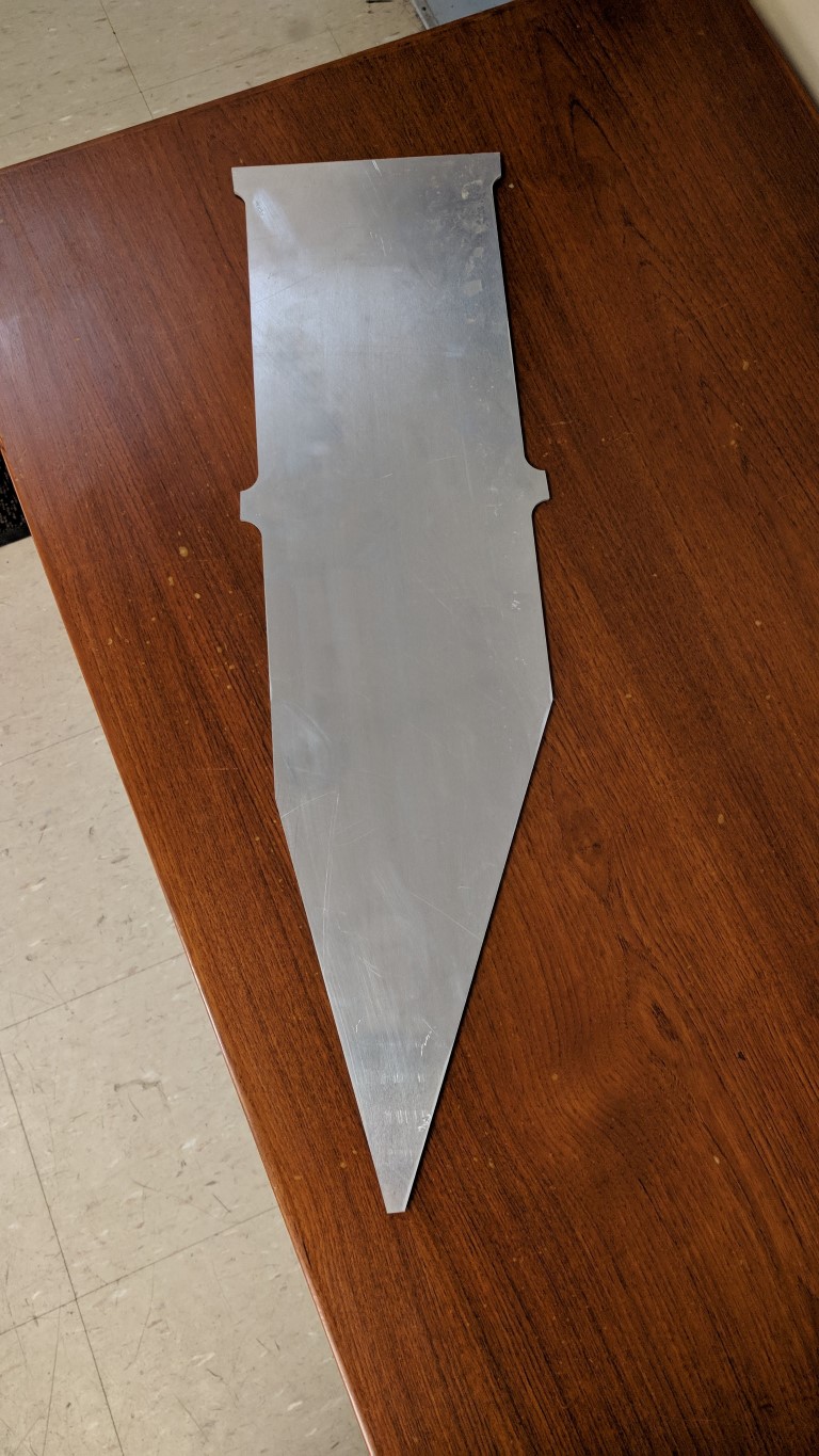

Brought that pdf file over to the waterjet cutting place and they zipped it right out.

John. Looks nice what did that cost if you don't mind me asking.
BILLS
Unread 05-18-18, 07:26 PM
kilr4d's Avatar
kilr4d kilr4d is offline
Join Date: Mar 2016
Location: CNC3
BILLS
No problem. $120CAD so about $95USD plus $20 cash for the 0.10" aluminum.
