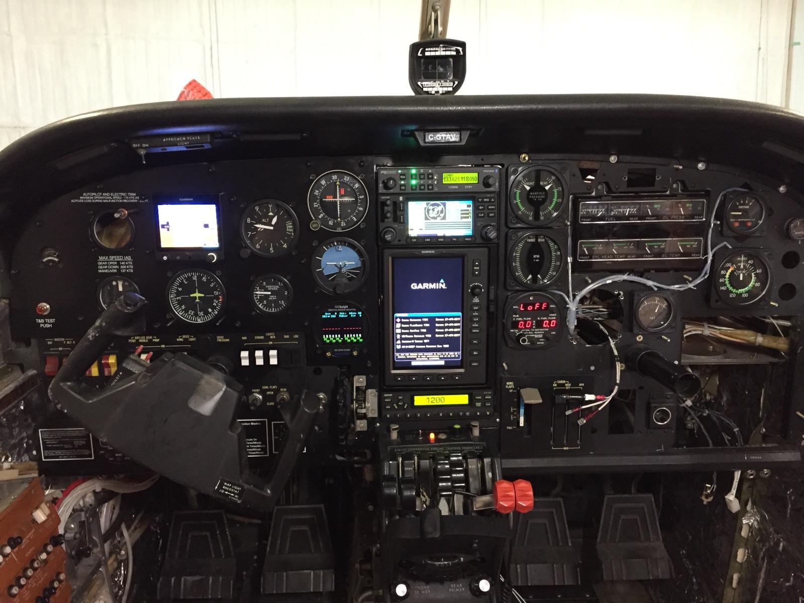

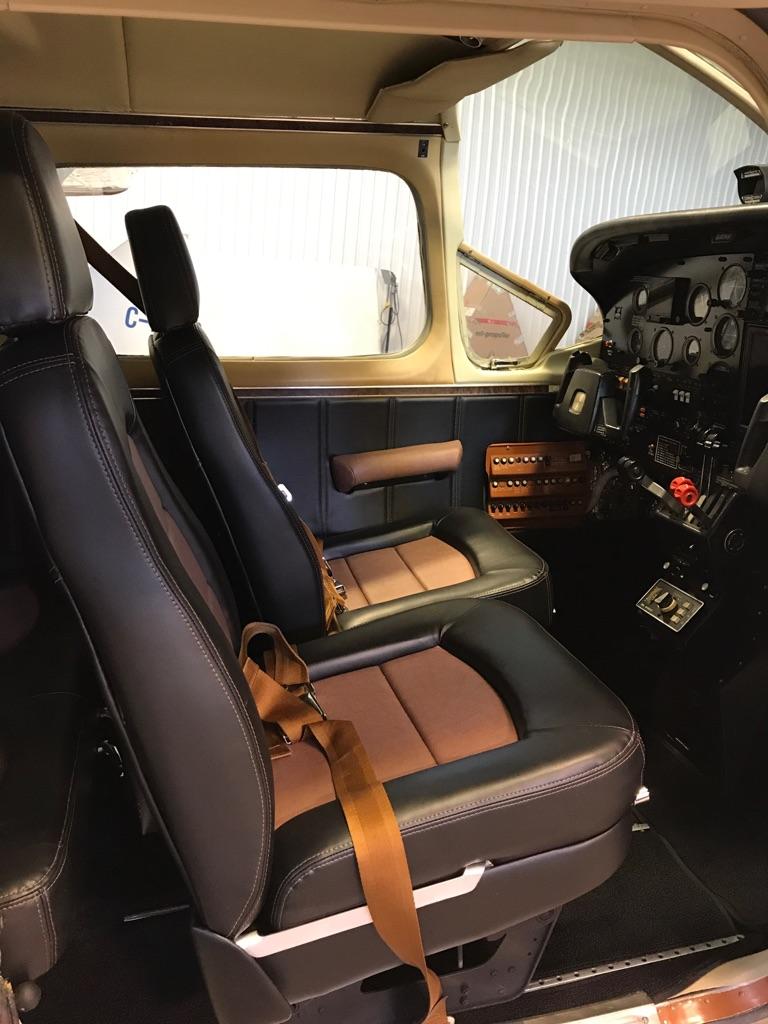

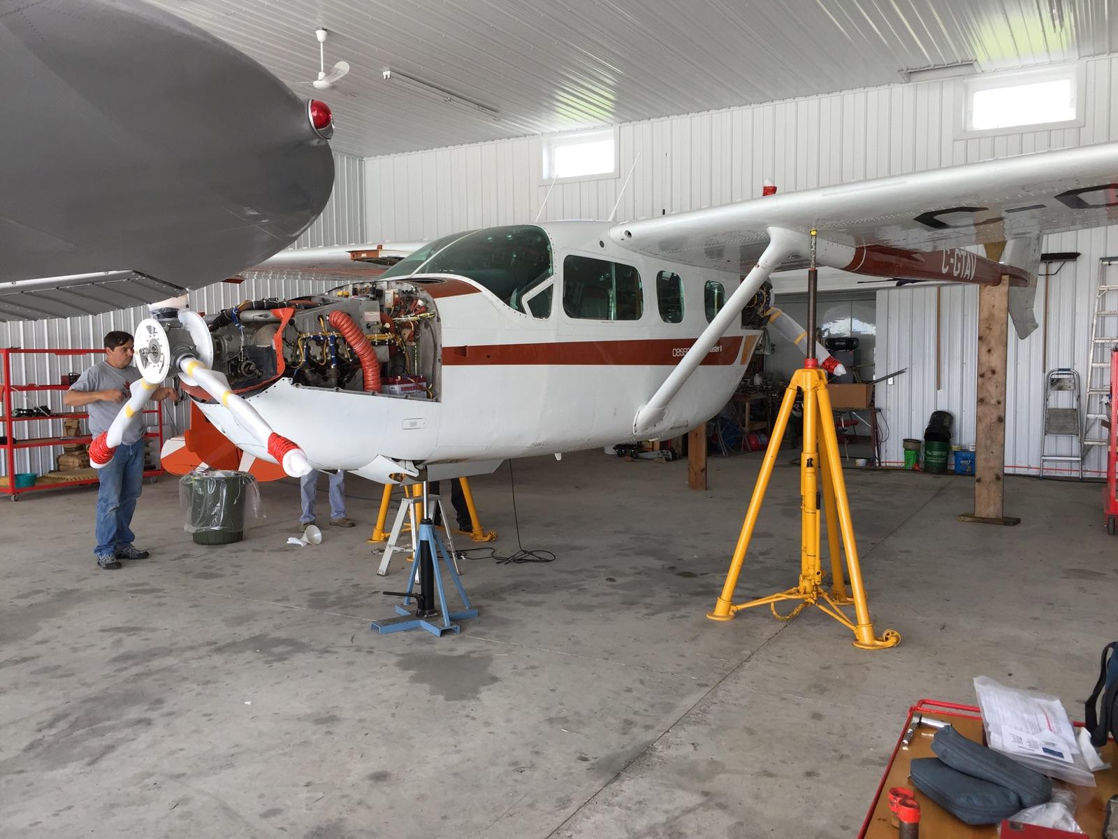

Unread 08-18-17, 07:57 PM
kilr4d's Avatar
kilr4d kilr4d is offline
Join Date: Mar 2016
Location: CNC3
It's been a long road but there's a light at the end of the tunnel. Props are on, gear swing is done, annual is done, panel is nearing completion and new interior is ready for installation.

Unread 08-19-17, 09:03 PM
Did you replace windows?
Unread 08-19-17, 09:21 PM
kilr4d's Avatar
Join Date: Mar 2016
Location: CNC3
No. The windshield had been replaced not that long ago. The side windows were in decent enough shape after we polished them up. All the side window seals and door seals are being replaced.
