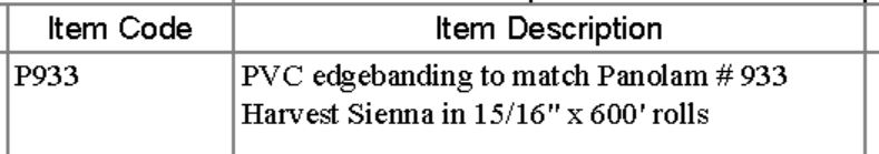

I just ordered some more as spares, the picture is the item code. If you buy some, being PVC it is very easy to break when cutting, even with a sharp blade.
I used some of the old material as a template for width, keep in mind that one side of the aluminium moulding has a recces, always put the new PVC strip in this side first, then it fits right in.
