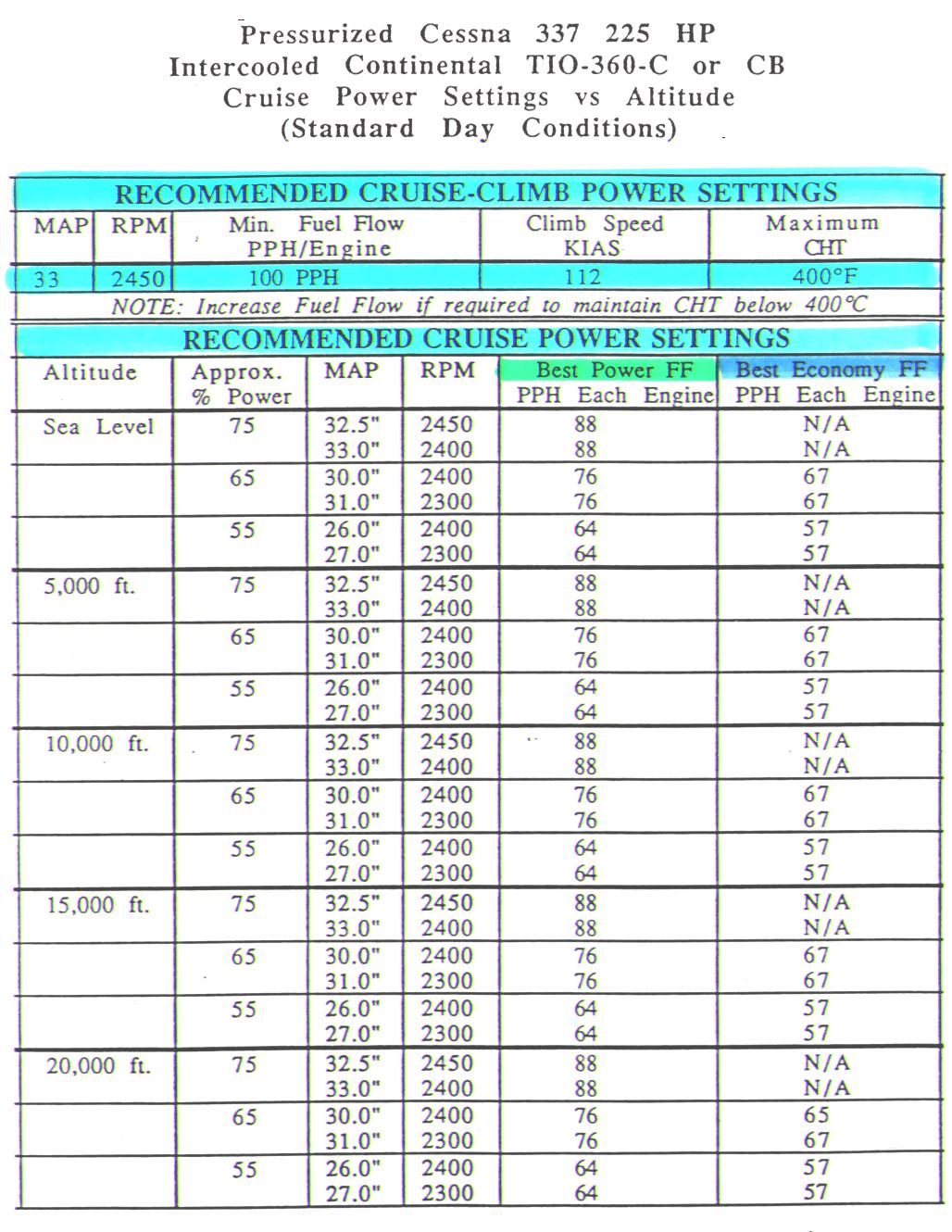

AA Intercooler - Recommended Cruise Power
Kevin, Bob, et al.,
Okay, maybe the following chart will help in the discussion, which shows recommended cruise-climb as well as normal cruise power settings.
Bob, your oil temps don't sound right... we very rarely see them approach 180 degrees unless it's a ++ISA day, and the rear engine always runs slightly cooler than the front with everything buttoned up. Maybe the Riley type intercoolers don't offer the same amount of "inter" cooling - ha! I've not seen the Riley up close, but from pictures it appears the radiator surface is somewhat smaller than the American Aviation units.
Another chart I attempted to scan wouldn't go, but basically the MAX POWER limitation is 35.3" MAP @ 2800 RPM for NORMAL takeoffs. For Density Altitudes above ISA, the chart reflects the correct MAP for a given condition, but in any event max is 37". Today, for instance, our OAT is 90 degrees at sea-level and the chart shows a MAP for takeoff of 36.3".
We normally cruise at 27" & 2300 RPM, and as you can see by the chart, that equates to approximately 55% power with a fuel flow of 57PPH each end using peak EGT for Best Economy, or 64PPH each end for Best Power. At this low cruise power setting, we opt for peak EGT or right in the middle, around 60PPH each end, so Kevin... you're burning more fuel than you need to -- if you have the AA intercoolers. We have the standard Cessna gauges and the dual Economy Mixture Indicator (EGT), which because of the probe placement in the exhaust stream is actually reading TIT. And note what the POH says... "Continuous operation at peak EGT is authorized only at 65% power or less."

I always run at 29/2450 or 31/2450 for cruise. Burn is about 27 gph at 50 rop for 68-70% hp (29").
re temps. rear engine does run warm based on OAT being isa++ with the air conditioning on. Normal front temp is 160 and rear is about 180. they would run a lot cooler if i ran at 55% power.
My humble opinion is try power is based on fuel flow at peak EGT then consulting the tcm manual and correlating to rpm curve.
Kevin, I wasn't trying to bait you. my argument is cooling the inlet air can can help to run the engine cooler and develop more potential output based on hot and heavy climbs. Fuel flow still dictates % power regardless of OAT or intercooler temperature.
Skyking, I do not have my poh with me but what is the cessna spec pwr based on same RPM and FUEL FLOW in your chart. Must be a couple of inches difference ? just a guess.

Bob,
Sorry that chart was so BIG... guess I need to learn how to make it "fit the window".
If it wasn't readily apparent after looking at the AA Intercooler Power Settings, as you can discern, the basic idea is to remember three power settings for any altitude based on 55%, 65% or 75%... e.g., it's always going to be 33" and 2400 RPM for 75%; 31" and 2300 RPM for 65%; and, 27" and 2300 RPM for 55% -- and their corresponding fuel flows, i.e., 88, 76 and 64 for Best Power (50 ROP), and if at or below 65%, peak EGT's resulting in 67 or 57 PPH respectfully.
Now, with respect to Cessna's POH... the chart for a stock airplane seems to have finite differences in BHP and Total PPH for a given altitude, ISA. So, let's just pick 10,000' and 18,000' for comparison and arbitrarily use 2400 RPM and 33".
At 10,000', Cessna POH shows 72% Best Power (50 ROP) with a fuel burn of 153 Total PPH for 2400 RPM and 33", and a TAS of 184 Knots. With the intercoolers the chart shows this same power setting giving 75% Best Power (50 ROP) and a fuel burn of 176 Total PPH, or 23 additional PPH (3.83 gallons per hour). BUT, the airplane equipped with the intercoolers is giving 195 KTAS instead of 184 KTAS as in the POH.
AHhhh, but drop the intercooled airplane down to 65% at the same altitude (30"/2400 RPM) where you can run lean peak EGT and your fuel burn is now 134 Total PPH with no penalty in airspeed... your speed is the same as the stock airplane at its slightly higher power setting... 184 KTAS ... and beating the stock airplane fuel flow by 19 PPH, or 3.16 gallons per hour. This latter figure isn't quite comparing apples to apples, because if you compare to the stock airplane's comparative per cent of power setting, the difference is only about a gallon per hour. So, it depends on how you want to skew the numbers.
OK, for 18,000' the stock airplane Cessna POH shows 71% Best Power (50 ROP) being developed with 33" and 2400 RPM, with a fuel burn of 150 Total PPH, resulting in 198 KTAS. With the AA intercoolers for the same altitude, 2400 RPM and 33" nets out 75% power and a fuel burn of 176 Total PPH- but you might need an extra 50 RPM spool depending on ISA conditions to keep MP steady, turbos spooled and pressurization happy, so running 32.5" and 2450 nets the same 75%. Again fuel burn will be 176 Total PPH, but speed will be 211 KTAS instead of the stock airplane's 198 KTAS, a distinct 13 knot advantage. Dropping the intercooled airplane down to 65% power results in 202 KTAS, and a fuel burn of 134 Total PPH, which is still better than the stock airplane at 150 Total PPH for 71% in addition to a slight speed benefit.
We very rarely run 75%... and unless we're going long, it really isn't economical to climb to the teens... but we like the pressurization and the turbos for mountain flying, and so we usually run 55% to 65%. At these power settings we can run lean and at peak EGT, thereby grabbing the fuel flow savings and also gaining speed over the stock airplane, at least at the higher altitudes.
If we run around local, say 5000' for a hop, we generally run 55% power which gets us down into the 114 Total PPH range, or 19 Gallons per hour and generally gives us about 160-165 KTAS on ISA days. Besides, we like to enjoy the ride, and these lower power settings are easier on the pocketbook and the noise levels are reduced too.
