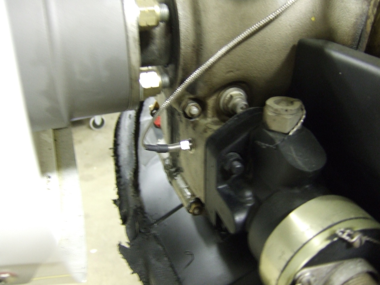

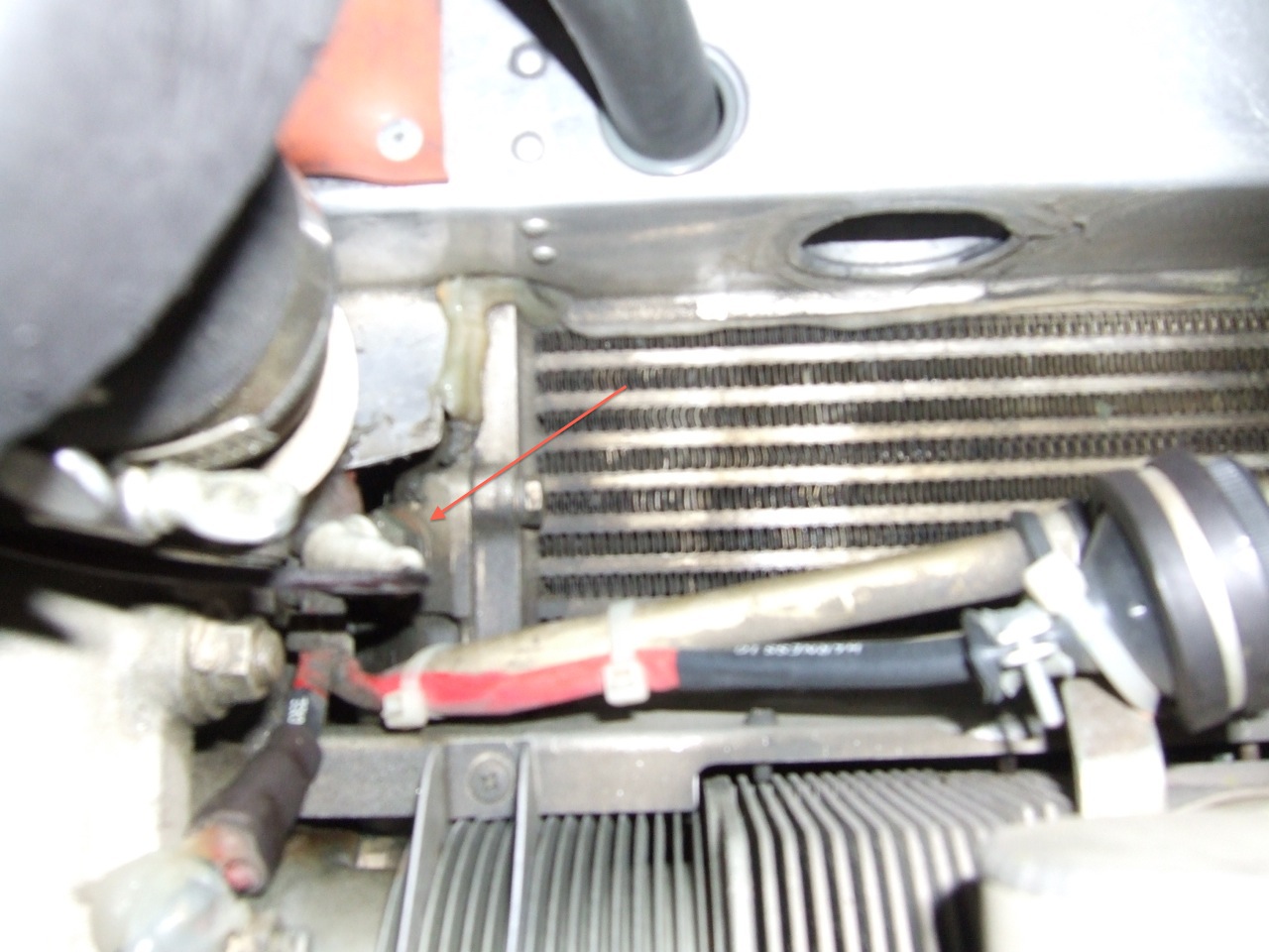

We installed the F&M adapters couple of years ago. Great system, they have been fantastic. As Kim indicated my sensor was in the oil cooler. I just installed the JPI and it has oil temp and used the port right behind the prop on the engine case. There is an plug right on top that can be removed with a hex key allen wrench. I will see if I have some photos.
Unread 09-28-11, 09:15 PM
Here is a photo of the front engine port and the rear engine port for oil sensor.

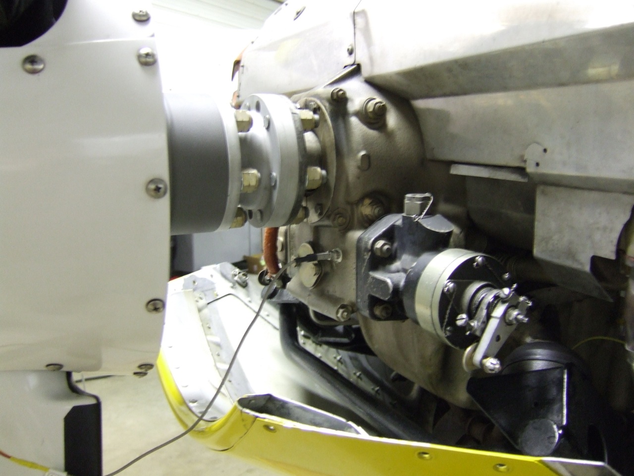

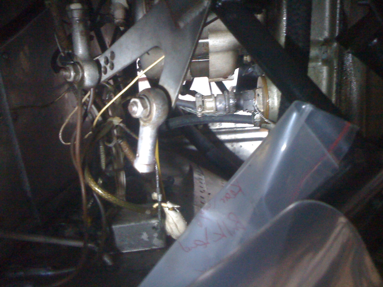

Here is the Oil Temp Sensor on the rear oil cooler. In the middle with the boot over the sensor for the wire connection.
