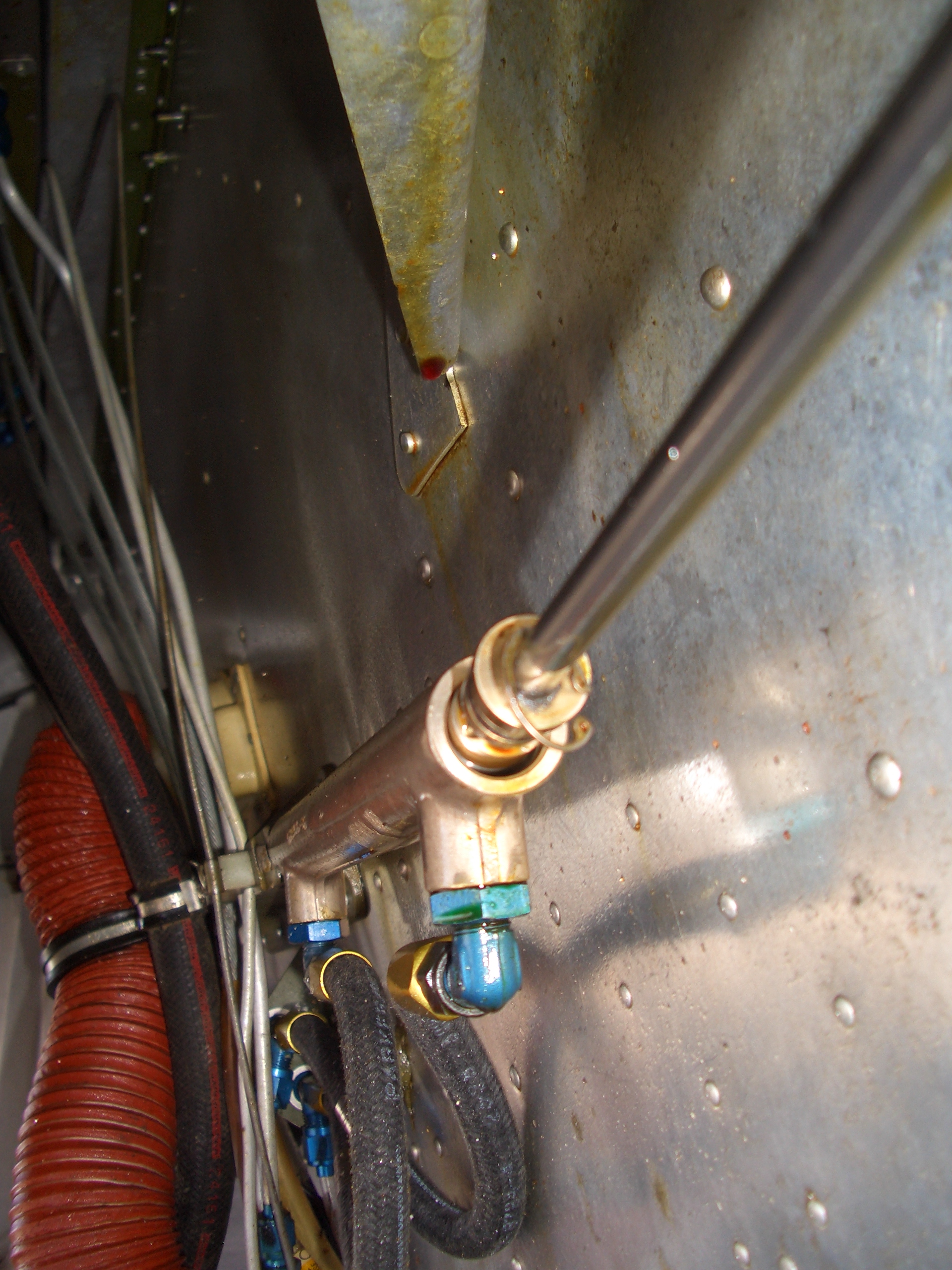

Anyone familiar with "gland end" actuators for the main gear doors? I recently had a 'gear up landing' due to mechanical failure of the right main gear door actuator snap ring. It appears the snap ring gave way and the end of the actuator came out of the housing causing all the hydraulic fluid to pump out. I have heard that some later models have what is called a 'gland end' actuator where the end screws into the housing rather than a snap ring holding it in place. My Skymaster is a 1977 337G, normally aspirated, non-pressurized.

Was it the snap ring that failed or the lip it sits in, inside the actuator?

My airplane has about 800 hours total on it, engines and airframe. I don't know why the snap ring or groove it fits into failed, if there are actuators with ends that screw on, I would like to consider them. Anyone familiar with this?
Unread 07-29-09, 05:06 PM
Posts: 514

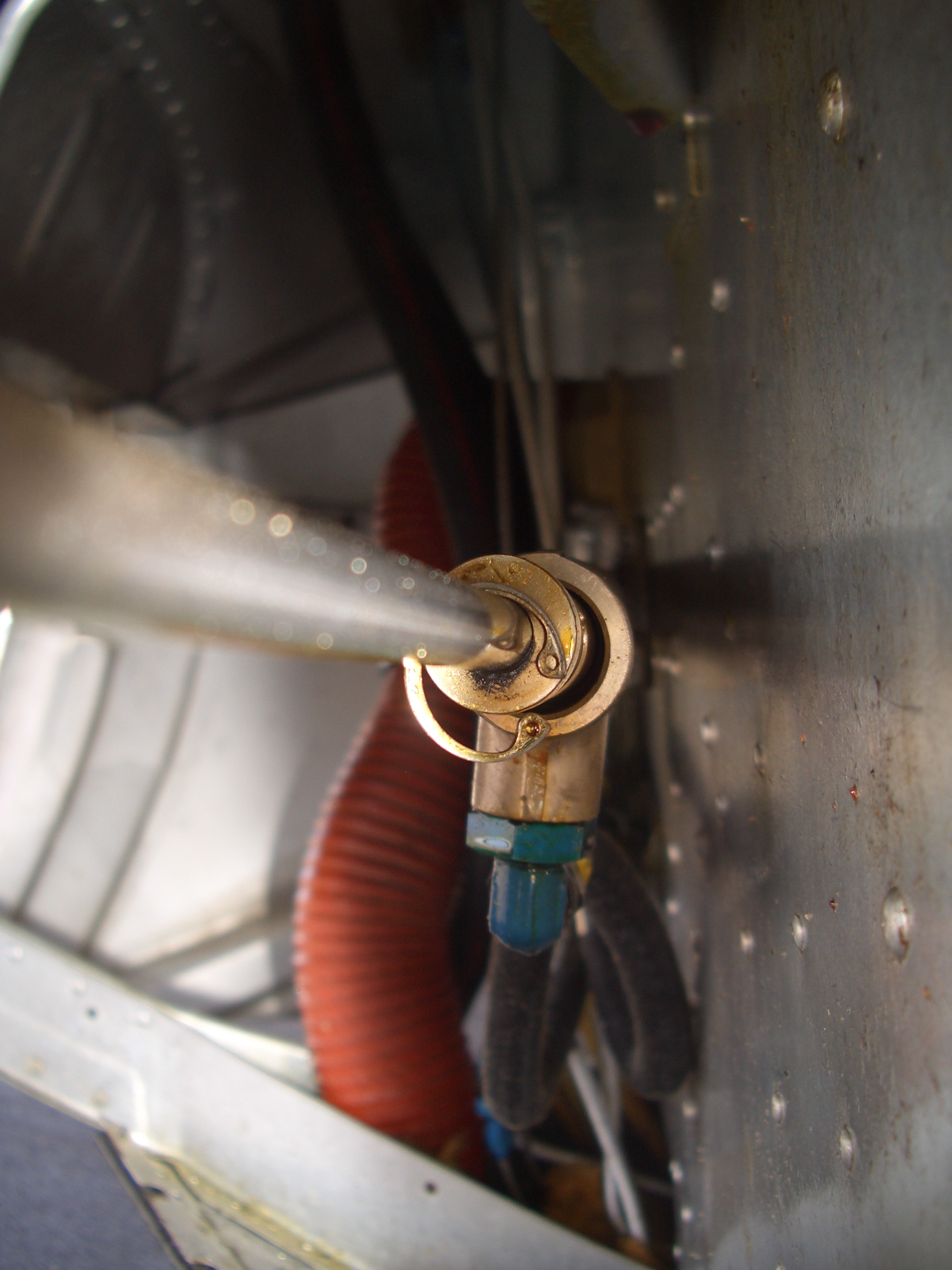

If you're able, could you post another pic of the snap ring and the actuator open-end taken straight on and closer-up? Thanks.

Here's the additional photos.
It seems this is a rare situation. Any thoughts on why this failure would occur and how to prevent it other than using the gear door modification?

I'm not sure I see anything wrong with the snap ring. It looks like the actuator housing let loose. Very hard to believe.
Unread 07-31-09, 12:36 AM
JeffAxel JeffAxel is offline
Join Date: Mar 2007
Location: Portland, Oregon
Posts: 150
Those snap rings can be put in 2 ways, and only one way is correct. One edge is slightly beveled, the other is sharp. The proper way to put them in is with the sharp side out, it grabs the groove better. Do it backwards and you see the results. It is amazing how many mechanics don't know this. The newer actuators with screwed in end fittings were installed in mid '78 model year P-Skymasters ( P3370298 and on), I am not sure if or when they put them in other models. The good news is you can use the newer actuators in place of the older ones if you can find them, at least in the P models. My guess is that this is true for all 1973 and later models, but I only have documentation for the P Skymaster. You could check with Cessna, or Tom Carr at CPA. Hope this helps.

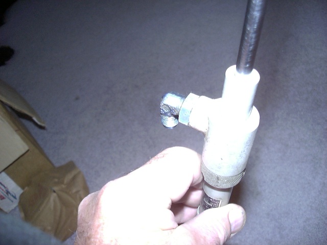

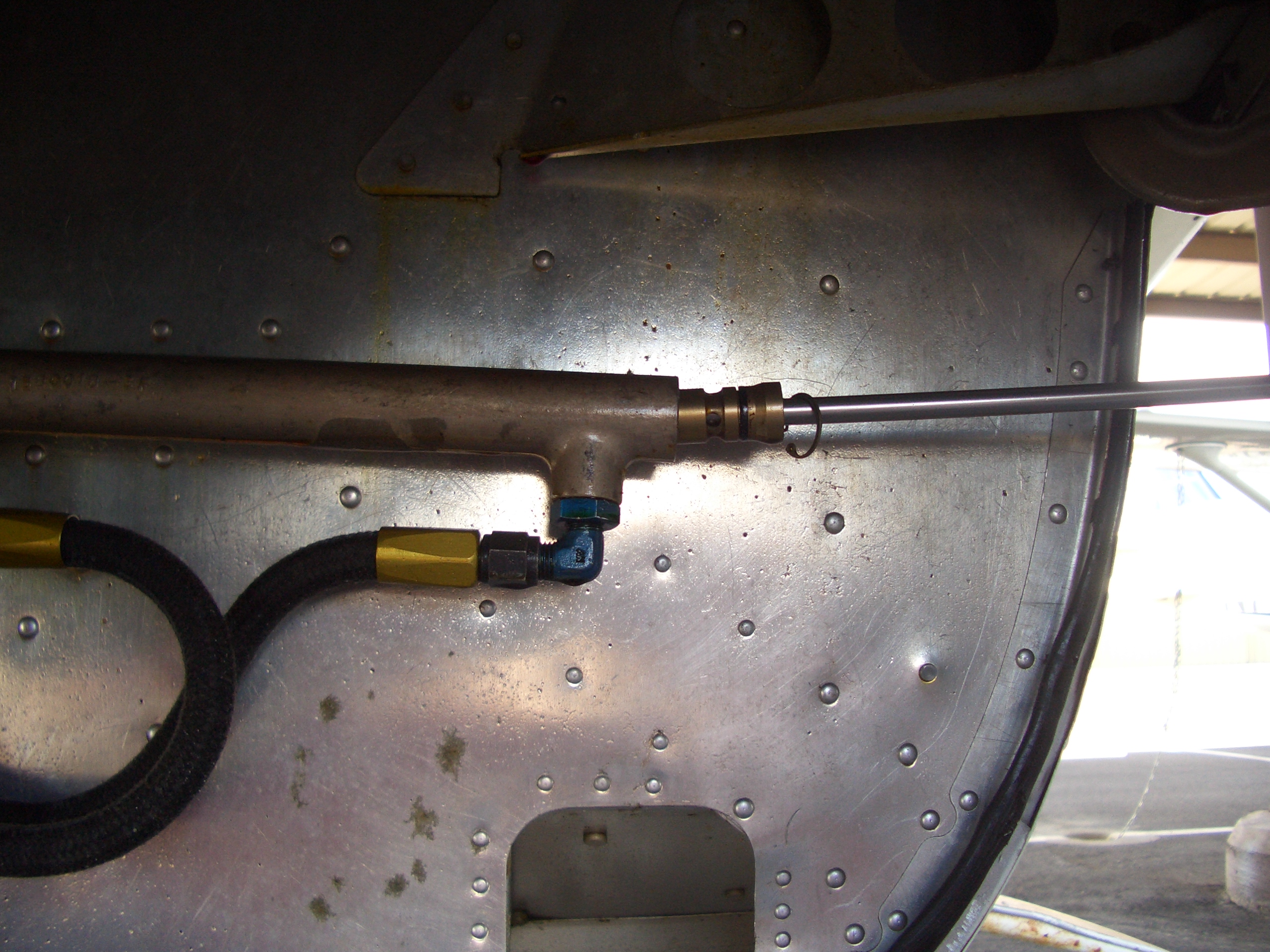

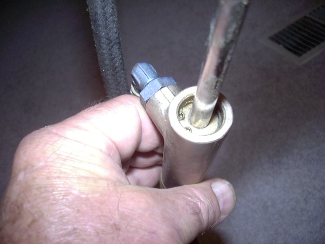

That's great Ed, I'm glad there has been some good come from my experience. The timing of your post is good because I am still undecided on whether I should replace the gear doors with the modification or put it back original with the "gland end" actuators that are available from Don Nieser. See part of an email communication below:
Todd I also looked at the Main Gear door actuators. The 1977 G parts catalog shows p/n 1580017-1 or -3 depending on aircraft serial number and the early model 337's and 0-2 aircraft used p/n 1280513-3 or alternate 1298110-3. I further checked and they all use the same door p/n, the same door hinge p/n and the same actuator mount p/n and the fuselage is no different at the rear firewall. Therefore my conclusion is that the early model 337 actuators and 0-2 actuator will work on your aircraft. The problem is getting approval. Attached are photos of the end of actuators like yours with the snap ring and a photo of an early model 337 actuator that does not have the snap ring. I have 3 of the p/n 1580017-1 and one p/n 1580017-3 actuators as removed for $950 each and a number of the p/n
1280513-3 as removed actuators for $750 each. Let me know and I can ship these parts to you right away.
I would still be looking at getting approval, but I think it would be worth the 'peace of mind', knowing the end of the actuator is more unlikely to fail than with the snap ring.
