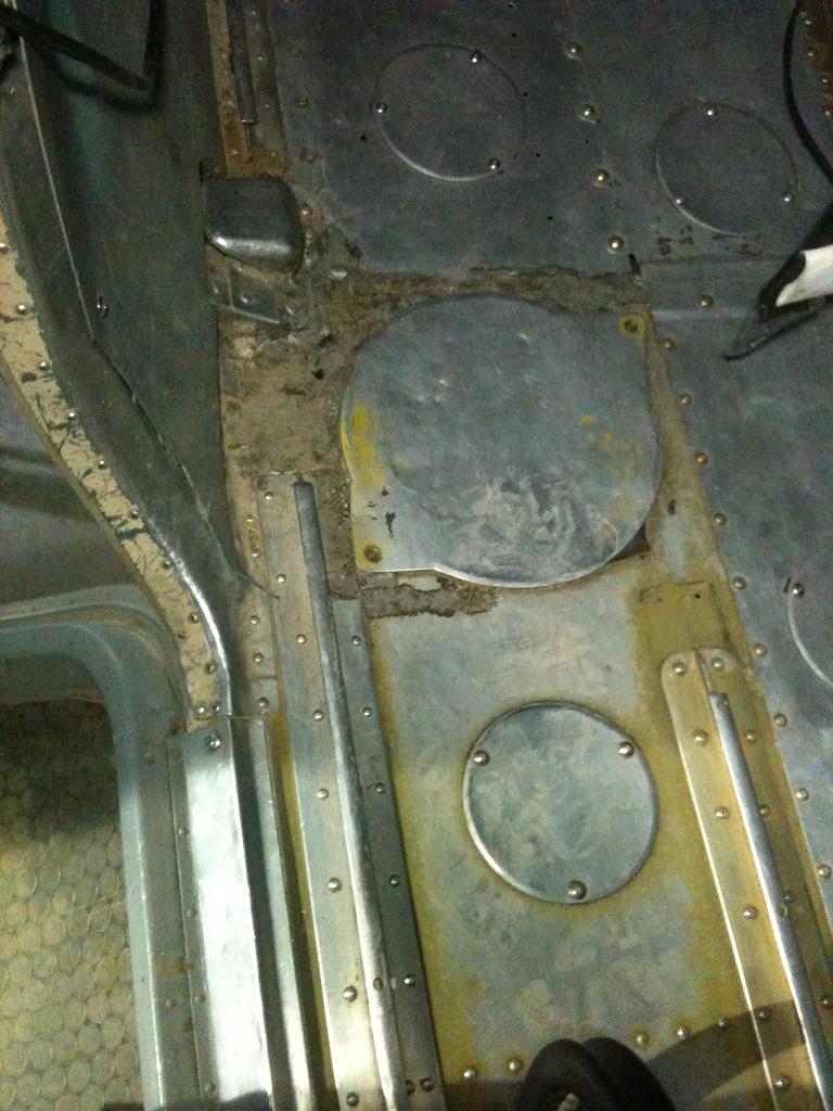

Camera Hole
The cessna camera hole was a option from S/N 33701463 through 33701874, it's shown in the IPC figure 37A. it's right behind the copilot's seat rails, I'll try to attach a pic of what it looks like from inside. I dont know of any STC'd camera provisions for the 337, however depending on the type of shooting you are planning on do there are several strut mount platforms that may be adaptable to your uses (http://www.lastrefuge.co.uk/), and it looks like a company has put together a very nice package for the singles (172,182) over at (http://www.airbornescientific.com/content/cessnacam).
hope this helps
cC

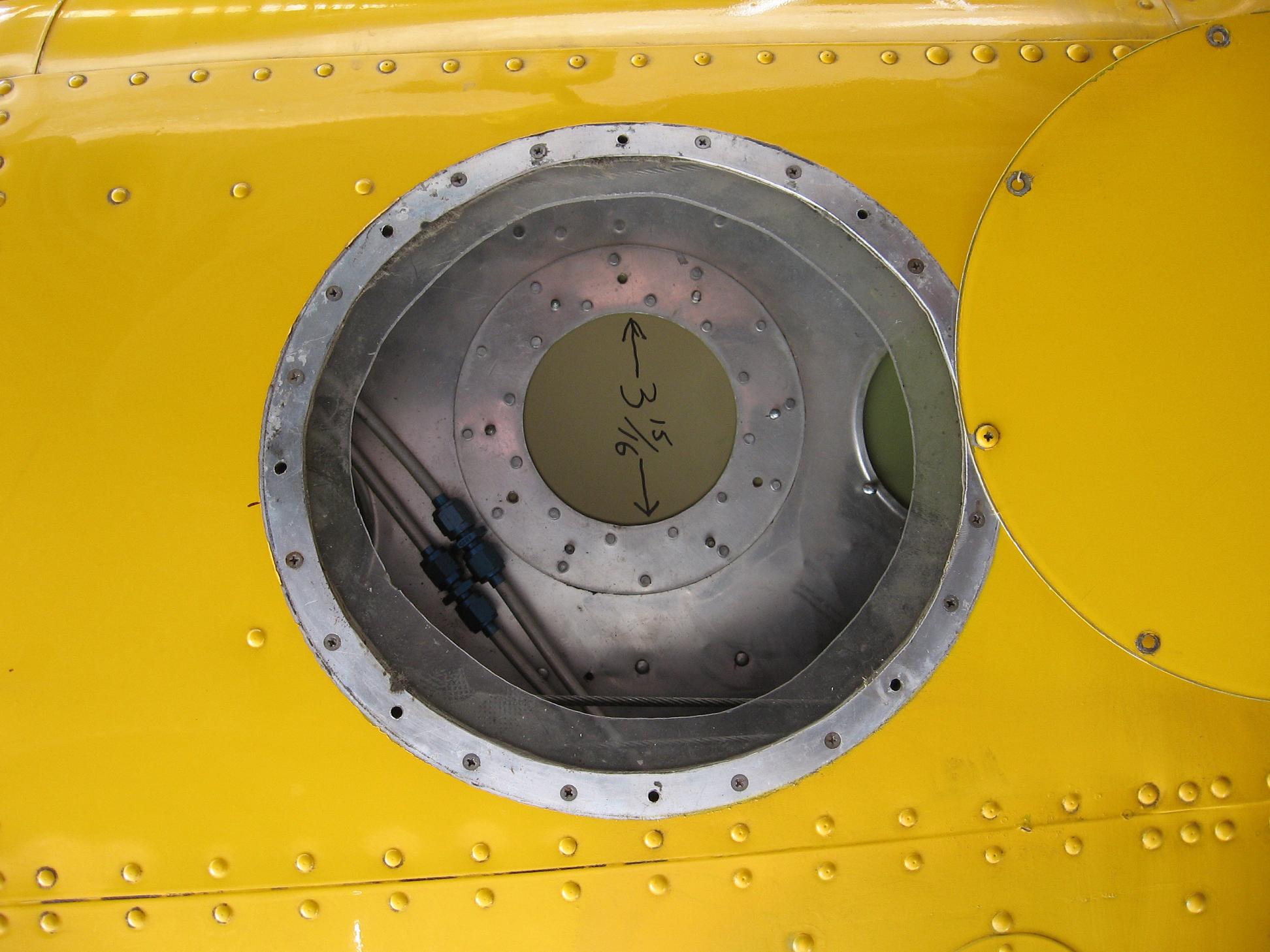

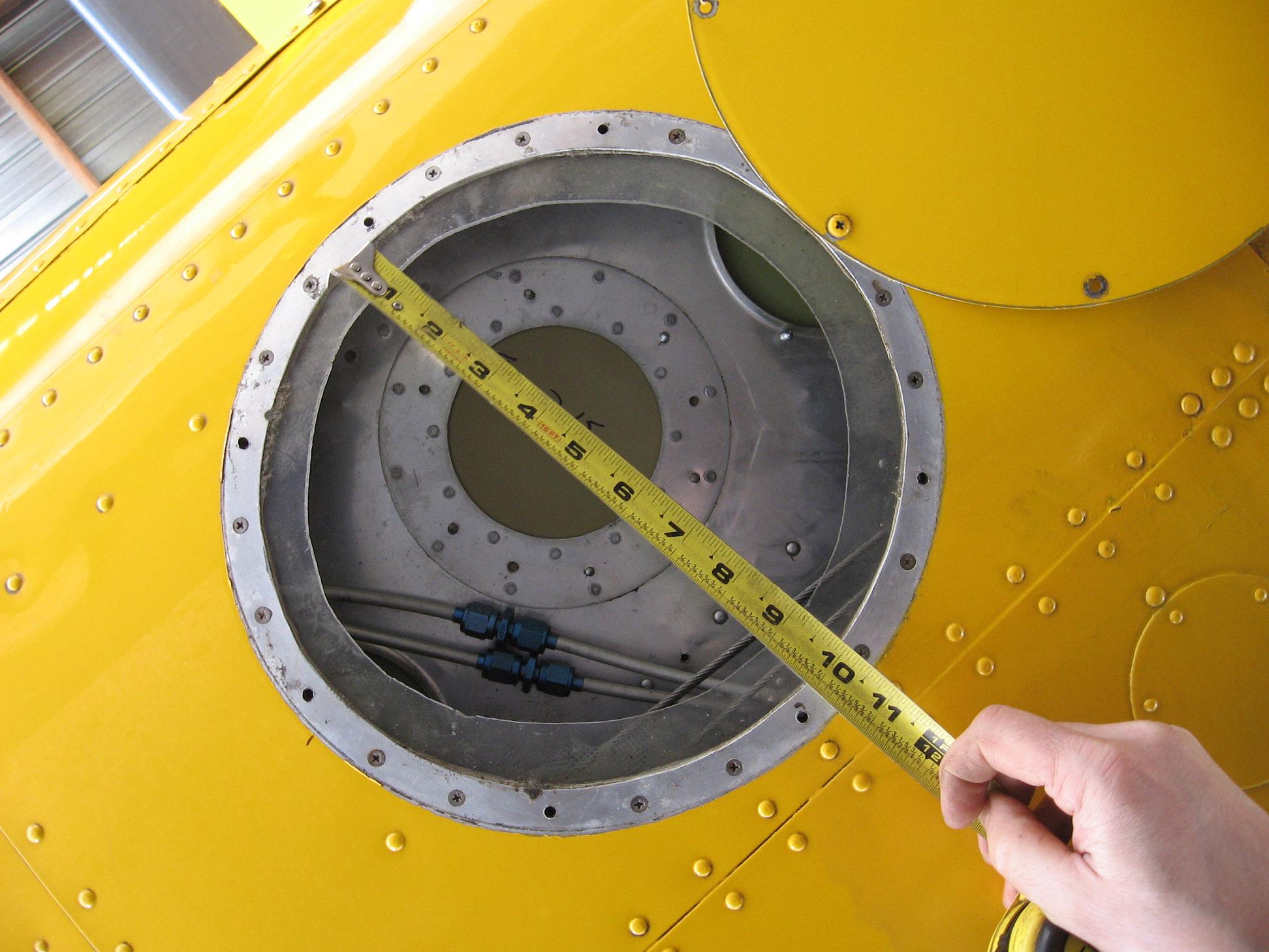

Here are some pictures of the belly
http://www.337skymaster.com/messages...1&d=1303666900
Name:	CFBTI Camera hatch 004.0.JPG
ID:	1239   Click image for larger version
Name:	CFBTI Camera hatch 005.0.JPG
ID:	1240   Click image for larger version
Name:	CFBTI Camera hatch 006.0.JPG

There are in fact two possible camera holes in the 337. A small one behind the pilots seat and a large one more or less underneath the co-pilots seat. Both appear in the parts manual so can theoretically be retrofitted with minimal paper work.
The big hole, which Cessna offered as a factory option, also often came with an electrically operated sliding outer door. I doubt it would be practical to retrofit this large hole to an existing aircraft. It requires a completely different floor sub frame, different control cable routing, etc..
The small hole is dead easy but you are limited to about a 6" diameter on the cabin floor. Wider on the outer skin.
I can send you detailed dimensions and pics if you are interested.
