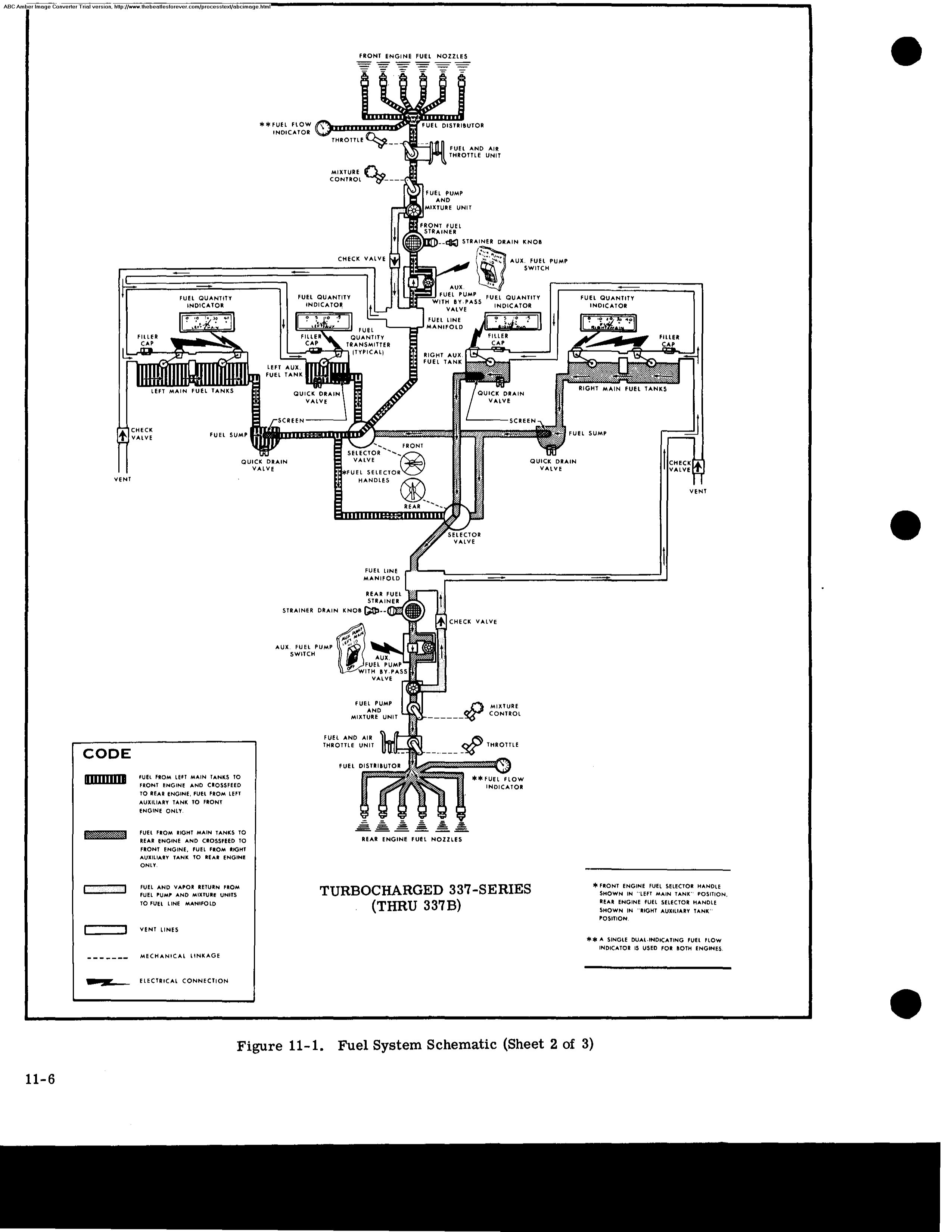

Unread 11-14-04, 07:25 PM
FRED-E's Avatar
FRED-E FRED-E is offline
Location: Oklahoma City
Posts: 187
Trbo Fuel Sys
This may help if I can get it to work
FredN358
Right click on the picture and select "Save Picture As" to a file so you can see it better.

Thanks to Fred for taking the time to post the diagram and to Frank for his suggestion.
Looking at the diagram my conclusions are as follows:
1. The auxiliary fuel pumps will draw fuel from whichever tank you have selected. In short, each pump is associated with an engine, not with a tank. This is the case for my current 337G, but was not the case for my previous 337D (which is covered in the paper cited*).
2. There is return fuel going back to the tanks, as you can see from the code legend at the bottom left of the diagram. So, an engine receives more fuel than it needs and the excess gets sent back to the tanks. From the diagram alone I cannot determine whether the excess fuel is roughly the same as the burned fuel (i.e., the engine receives about twice as much fuel as it needs), as is the case for the non-turbo 337D.
3. It appears from the diagram that excess fuel from the front engine goes to both the main and auxiliary tanks of the left side, and excess fuel from the rear engine goes to the tanks on the right side. So this is different from the 337D, where the excess fuel goes only to the main tank. Frank's suggestion to see if your POH says to burn 1 hr fuel from the mains before selecting aux would confirm this. From the diagram, I'm concluding that your POH will not say that, because fuel returns to both. One unanswered question is how much to the main and how much to the aux.
4. If you are cross-feeding (which can only be from the opposite main, never from the opposite aux), excess fuel does not return to the tank from which you are feeding. If the rear engine is being fed from the left main, excess fuel goes to the right main and right aux.
From the above, you can infer operational scenarios. For instance, if you use all the fuel from both left tanks, cross-feed the front engine to draw from the right main and the right main eventually runs out of fuel, where will you find fuel? In both left tanks (the excess that came back from the front engine while it was feeding from the right main has partially refilled these tanks), and possibly in the right aux. You also recognize that the fuel in the aux left tank is not available to the rear engine and the right aux fuel is not available to the front engine; in a very long flight over inhospitable terrain (like Brian von Herzen's Skymaster flight to Europe via Greenland and Iceland) it would be advantageous to use the aux fuel as early as possible in the flight, so that if an engine fails later, the remaining engine can have access to all of the remaining fuel.

Unread 11-15-04, 12:54 PM
Ron:
I think the language of the POH still leaves unclear the question of fuel return. As you can see in the diagram, there is a return line from the manifold back to the tanks, with an arrow pointing to the tanks. Is the vent only for vapors or both vapors and fuel?My guess is that some excess fuel goes back to the tanks, but it might be a minimal amount, with most "recirculated to the engine-driven pumps".

Unread 11-16-04, 04:58 AM
bawb bawb is offline
Join Date: Aug 2002
Posts: 22
bawb is an unknown quantity at this point
The T337B is unique. Excess fuel returned from the engine goes to a fuel manifold, which looks like an aluminum whiskey flask mounted on the side of the fuselage. The engine is taking more fuel from the manifold than it is returning. The shortfall is made up for by fuel from the selected tank. The vent line comes from the high point of the manifold, and is connected to both the main and aux tank.
Consider what happens in that manifold: Fuel is drawn out by the pump and a lesser amount of fuel is returned by the pump. There is nothing forcing the fuel up the vent line except head pressure from the selected tank. Since the vent line is plumbed into the top of the tank, under normal circumstances, no fuel returns to either tank.
With this system, there is no need to burn an hour out of the mains before switching to the aux tanks. On a maximum range trip, the aux tanks should be selected early as aux fuel from the affected engine is not available to the surviving engine if one quits.
The POH for the T337B does not mention burning fuel from the mains for any length of time before selecting aux tanks. The manual does state on 2-1: "Vapor and excess fuel from the engine-driven fuel pumps are returned to the fuel line manifolds, and the returned fuel is recirculated to the engine-driven pumps." On page 7-1, regarding the auxiliary fuel system, the POH states: "Fuel vapor and excess fuel from the engine-driven fuel pumps are returned to the fuel line manifolds, and the returned fuel is re-circulated to the engine-driven pumps." Excess fuel does not return to the tank.
This system is distinctly different than that found on most other Skymasters including non-turbo models of the same year.
