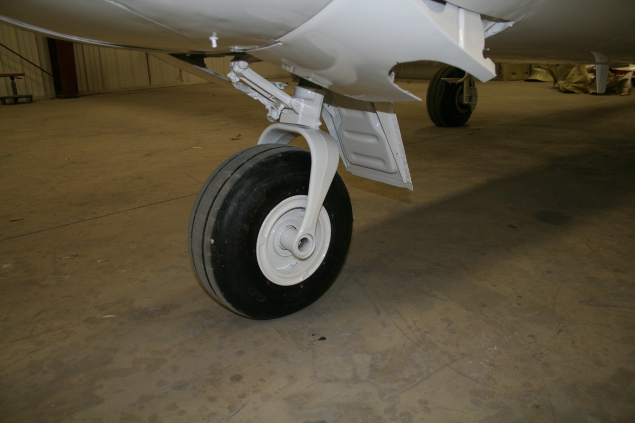

Need some help, I have removed both front cowl flaps for inspection, strip and paint. Once both flaps were removed I noticed the right flap was different in the vertical skin to the left, the part you see when the flap is extended (can't think of anyother way to describe it).
There is a little tidy up work to do on this verticle piece were it is folded over 90 deg. But I question is there tidy up work because some of it has broken away.
Have not been able to locate any drawings or pictures to refer too, would any of you be able to extended right cowl flap and take a photo of it, in particular the inside looking upwards next to the exhaust.
No other 337's near by for me to look at, closest is about 3hrs drive away.
Regards
PS: Thought I would share a photo of the project, we have almost completed the tail section and booms, they should be painted in the next few weeks. Then onto the wings before finally the fuselage. The photo is after a weekend of paint stripping all 3 layers of paint, what a mess acrylic makes, nose cowls left until removed for preparation by hand.

The photo's are exactly what I am after, they clearly show me I have some more fabricating to do in replacing the vertical piece on the R/H cowl flap.
Although not worn away to badly we will manufacture a replacement, the rest of the cowl flap is near perfect. Unfortunately I have not been able to locate this one particular piece and even the parts manual refers to a complete unit.
