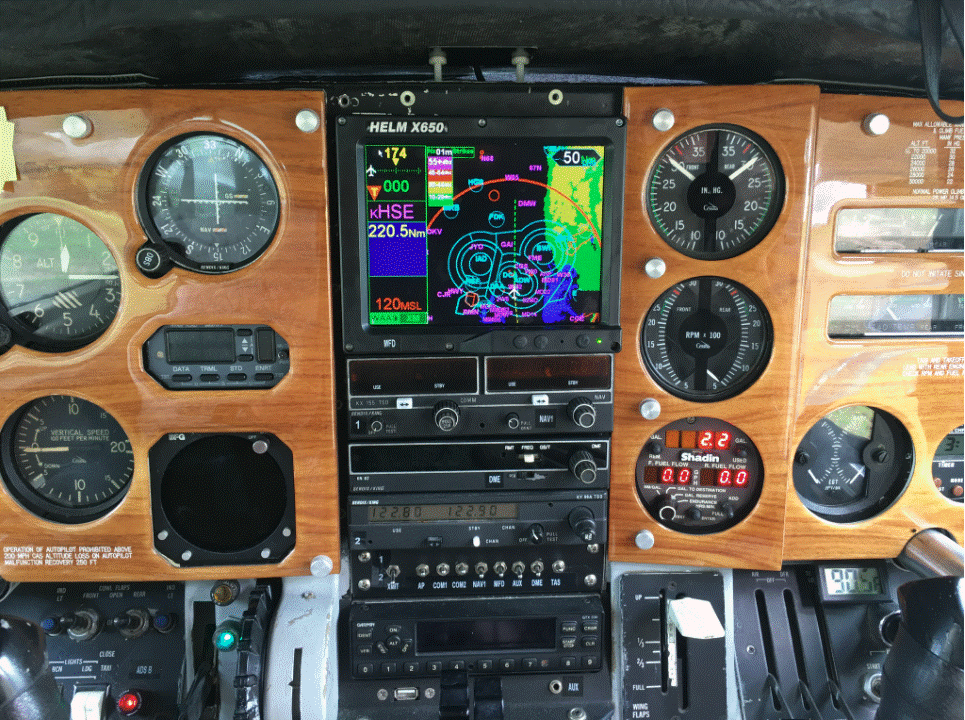

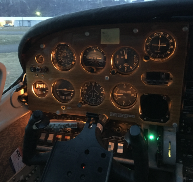

On images below, from the top down
CENTER AVIONICS STACK – 14-15 inches avail
1. Helm x650 (INC XM WEATHER)
2. KX155 ILS/NAV
3. KN62 DME
4. KY97 COM
5. AUDIO SELECTOR (original with huge blob in avionics bay)
6. GARMIN 330
7. IPAD MINI Running foreflight
LEFT
8. RYAN 9900BX Needs brain fixed flat rate $2,500 and maybe top antenna $500?)
9. WX950 STORMSCOPE
IN AVIONICS BAY
10. XM RECIEVER
11. L3 K2500 WAAS ADS In/OUT w WIFI
12. TRANSCAL ENCODER
13. AUDIO PANEL
WIRING
The TRANSCAL encoder feeds altimeter to the Garmin 330
The Garmin passes the TRANSCAL encoder altimeter to the 9900BX via ARINC 429
The original Cessna ‘audio’ panel occupies a lot of space in avionics bay. A very stale bowl of wiring spaghetti
PROBLEMS
1. The HELM X650 and its software end of life
May lose panel mounted map (hi vis and never shuts) and XM weather at any time
Foreflgiht et al OK, powered by CIG, but prefer panel mount
Would need GDL52 to received ADSB + XM? How to get Avidyne XM?
2. RYAN 9900 BX needs CPU repair (flat rate $2,300?) and possibly antenna
Still the only device captures it ALL and REALTIME, ANYWHERE
Does ADS-B make TCAD redundant? Just pull and remove antennas? Or fix?
3. The 9900BX reports ‘altimeter error’ periodically. Problem with Garmin 330 ARINC 429?
NOTE: I hardwired a DB9 input to 9900BX to give a fixed altimeter value (500ft)
and it no longer reported altimeter problem.
Suggests Garmin 330 ARINC 429 problem?
OBJECTIVE
I understand AVIDYNE user I/O to be much more user friendly than Garmin?
Avidyne displays CAN display a repaired RYAN 9900BX output too.
SO MAYBE…?
NAVIGATION
Avidyne
GPS only?
Or w NAV/COM. Trade in KY97 or KX155?
TRAFFIC
Fix 9900BX and feed to Avidyne above
WEATHER
How to get XM into avidyne?
Just use Forefligth /stratus?
Get GSL52 for ADSB and XM and port to …Foreflight? Avidyne?
AUDIO
Does integrated NAV/COMM unit make need for autio panel redundant?
PMA panel? Remove Cessna ‘audio panel’ and wiring?
….What IS a mother to do?

After 2 some years getting 4FZ airworthy, I gave quite a bit of thought to avionics to come. My final decision was to buy the following:
Garmin 345 with Bluetooth.
Garmin GTN-750 used w/8130 from Garmin. Much more like an FMS like I am used to in the airlines for programing, not like a 530/430. Has all the airways. Avidyne Navigator will work well for that to, but did not find one at a fair price.
G5 DG/HSI w/GAD-29 /GMU-11/LPM to replace my DG.
These will be integrated with my Garmin 335 TXPR ADS-B out.
Will keep my ADF and DME. Cessna 485's will come out, looking for a SL30, at worst one of my KX175's will go in as a backup. Stormscope will stay for now. Will use an Ipad for ADS-B in and WX avoidance planning, not to stick my nose into it. Live Radar is the ONLY thing for that, but not in my future now.
And it is all about how you want to use your plane, not someone else.
Let the fun begin!
