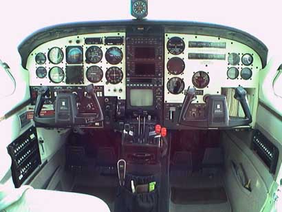

Jazzman:
Here are some more pics of the low-time 1978 P-model, N90BK.
