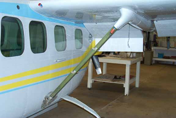

Another pix...
Just for those who've never seen the strut with the fairing removed, exposing the heater and cable guides, here's a good shot.
SkyKing
