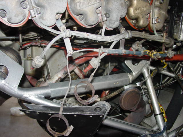

Unread 03-23-03, 02:33 PM
Location: galveston
Posts: 126
Thumbs up heat shield
attached pic of my recently completed heat shield
