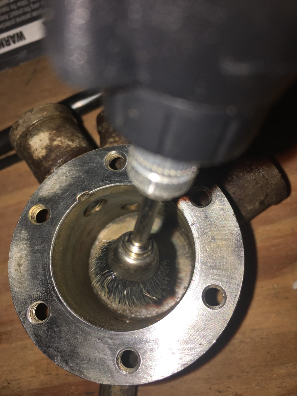

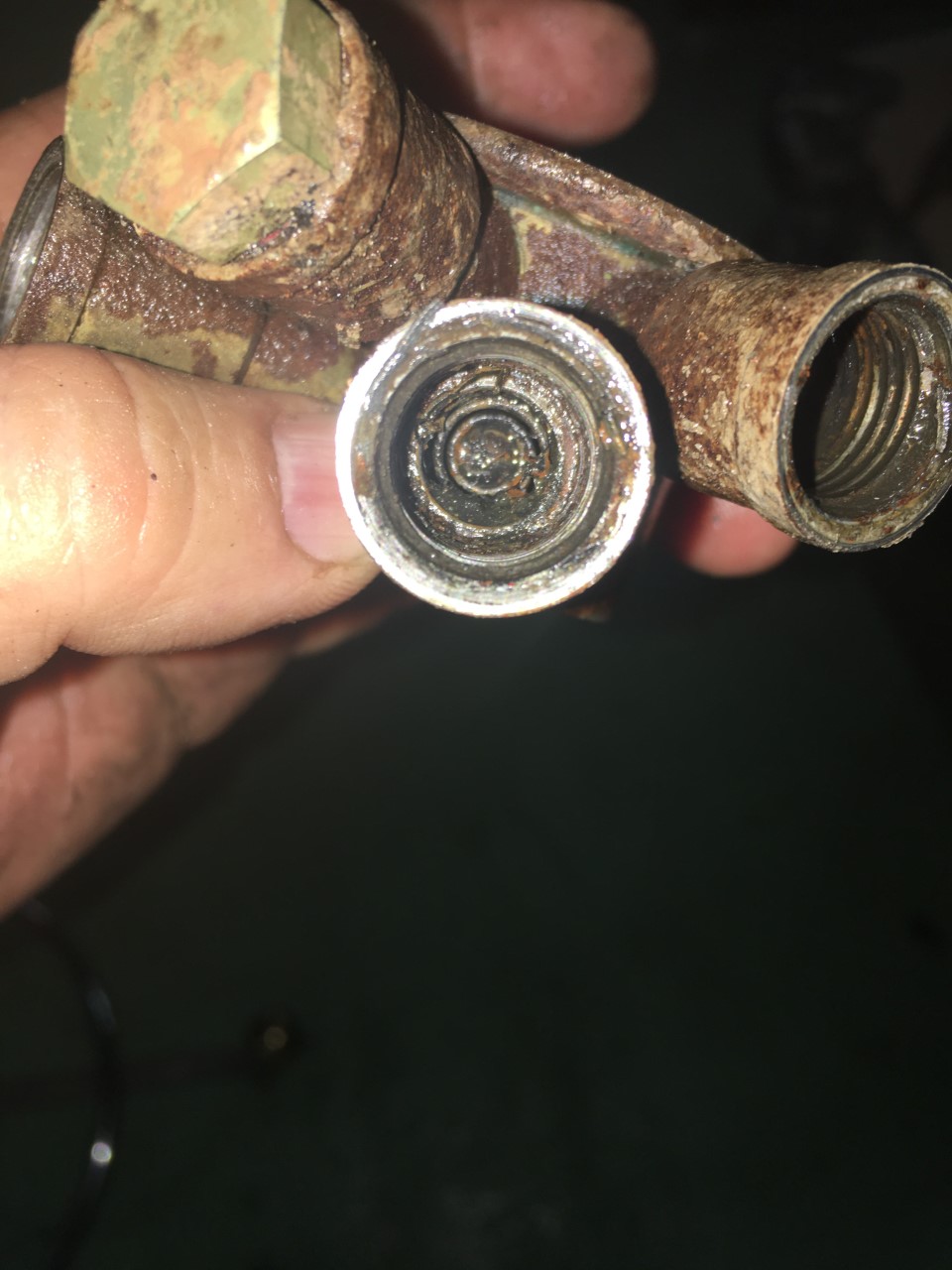

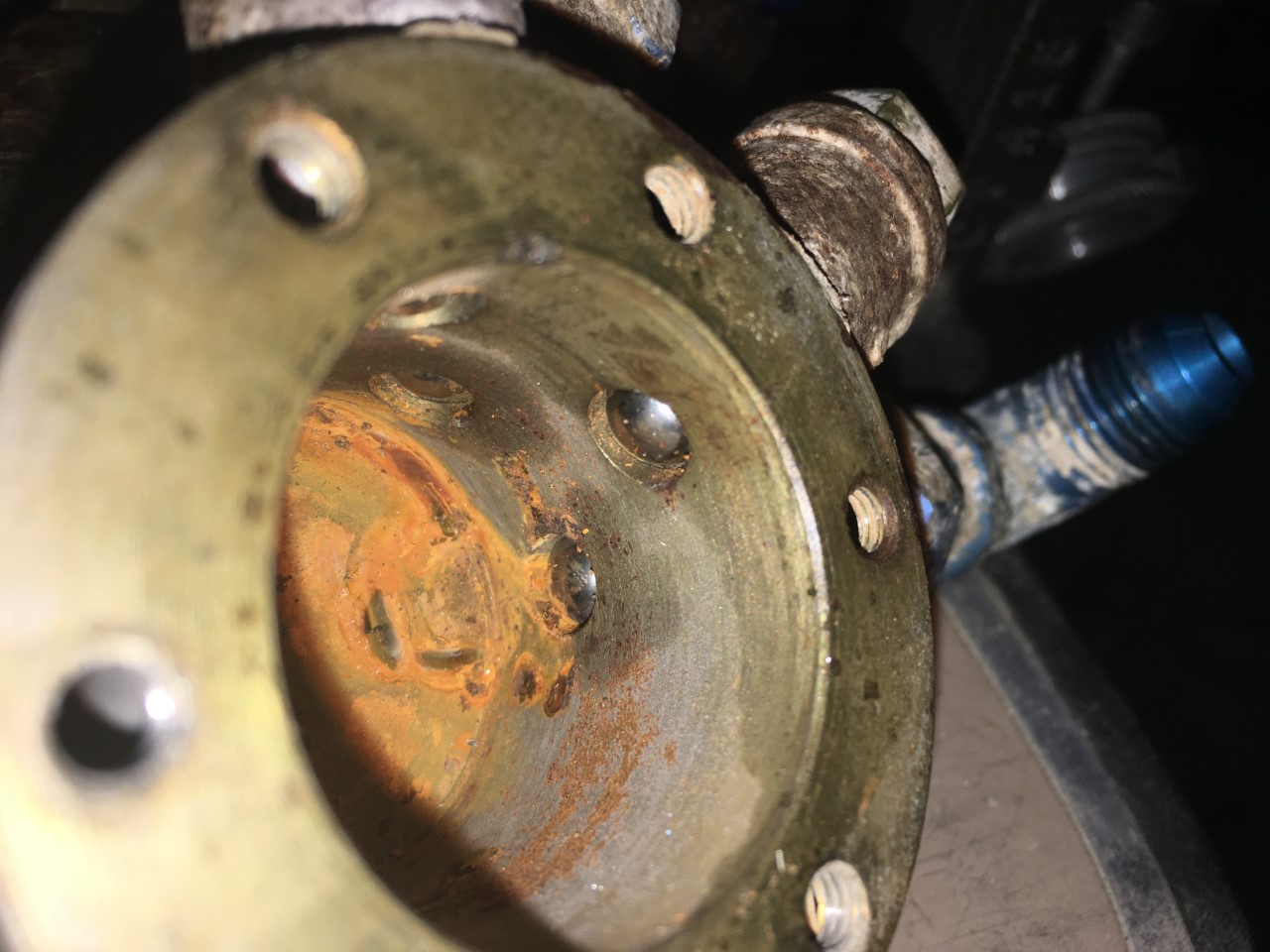

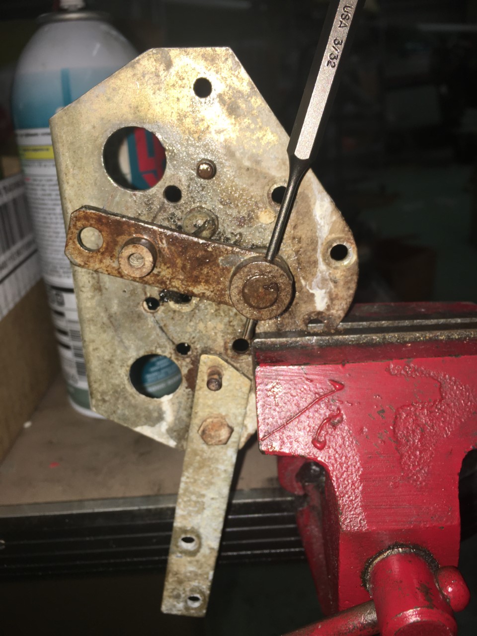

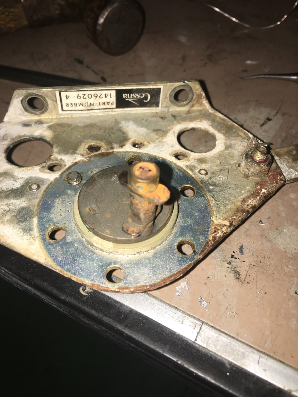

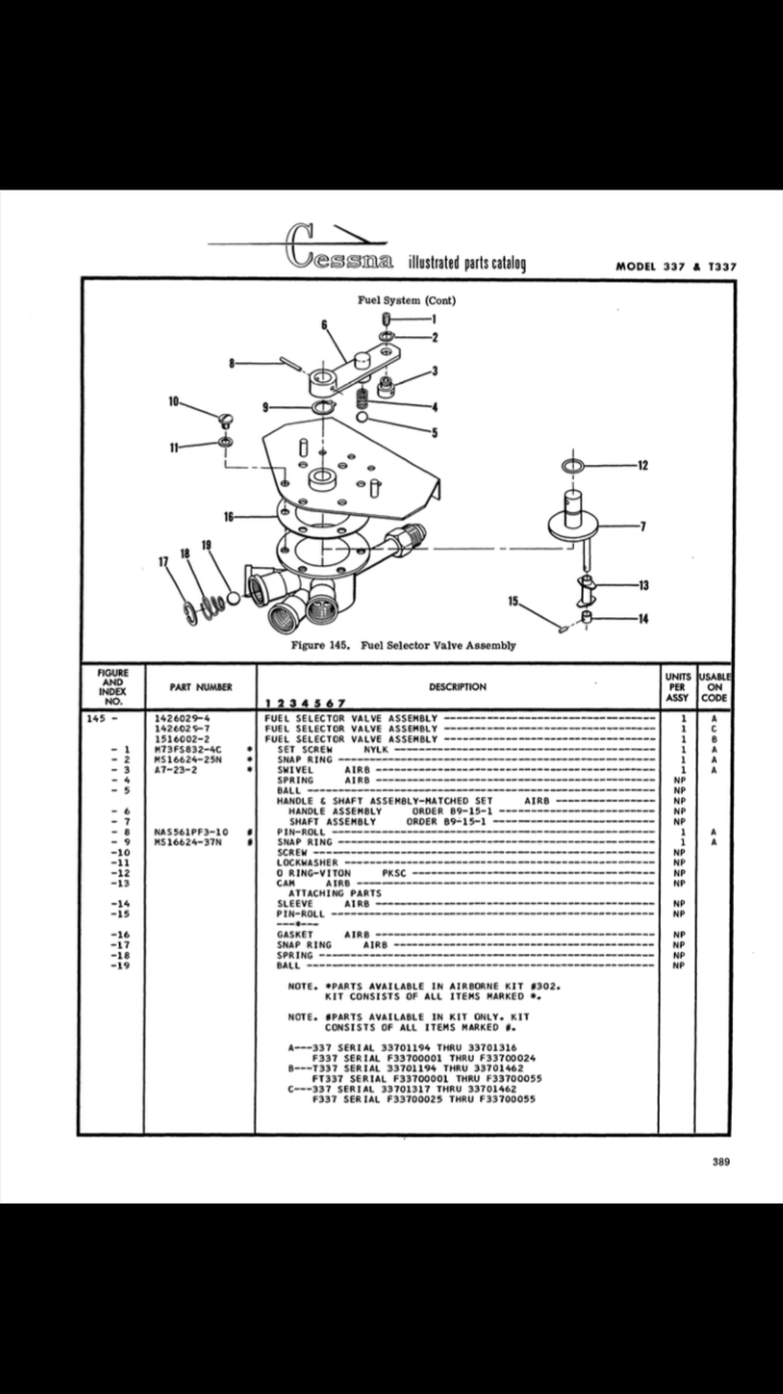

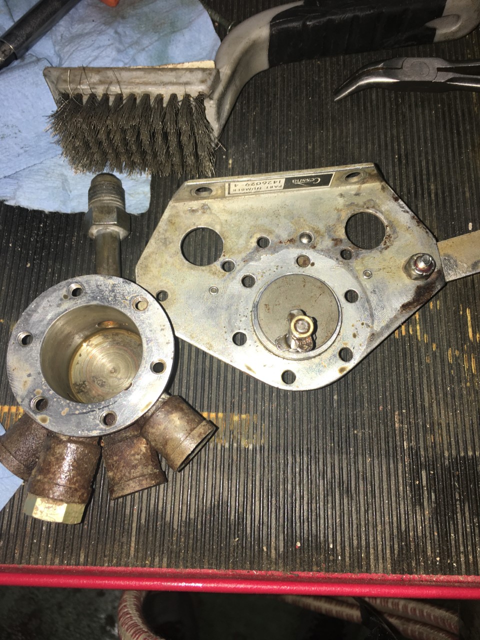

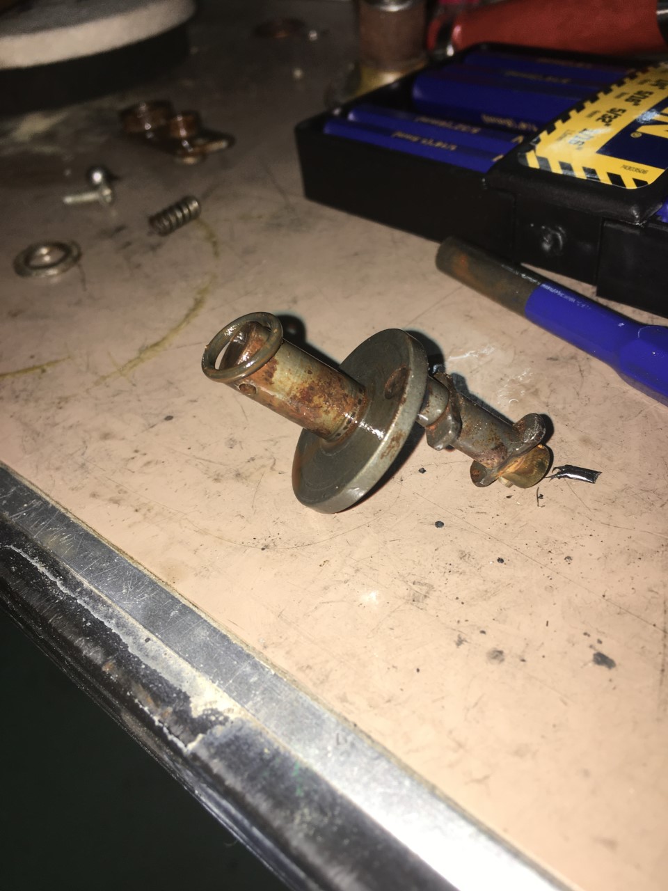

So, I am going to try and post pictures of what I did. My valves had locked up due to rust build up in the "cup" and this was making the "cam" (a cross shaped actuator that pushes the balls open to allow fuel to flow out of a portal into the main chamber, "cup") bind. I had also had a problem with one of my portals not providing positive cut-off and that was ultimately found to be deteriorated o-ring.

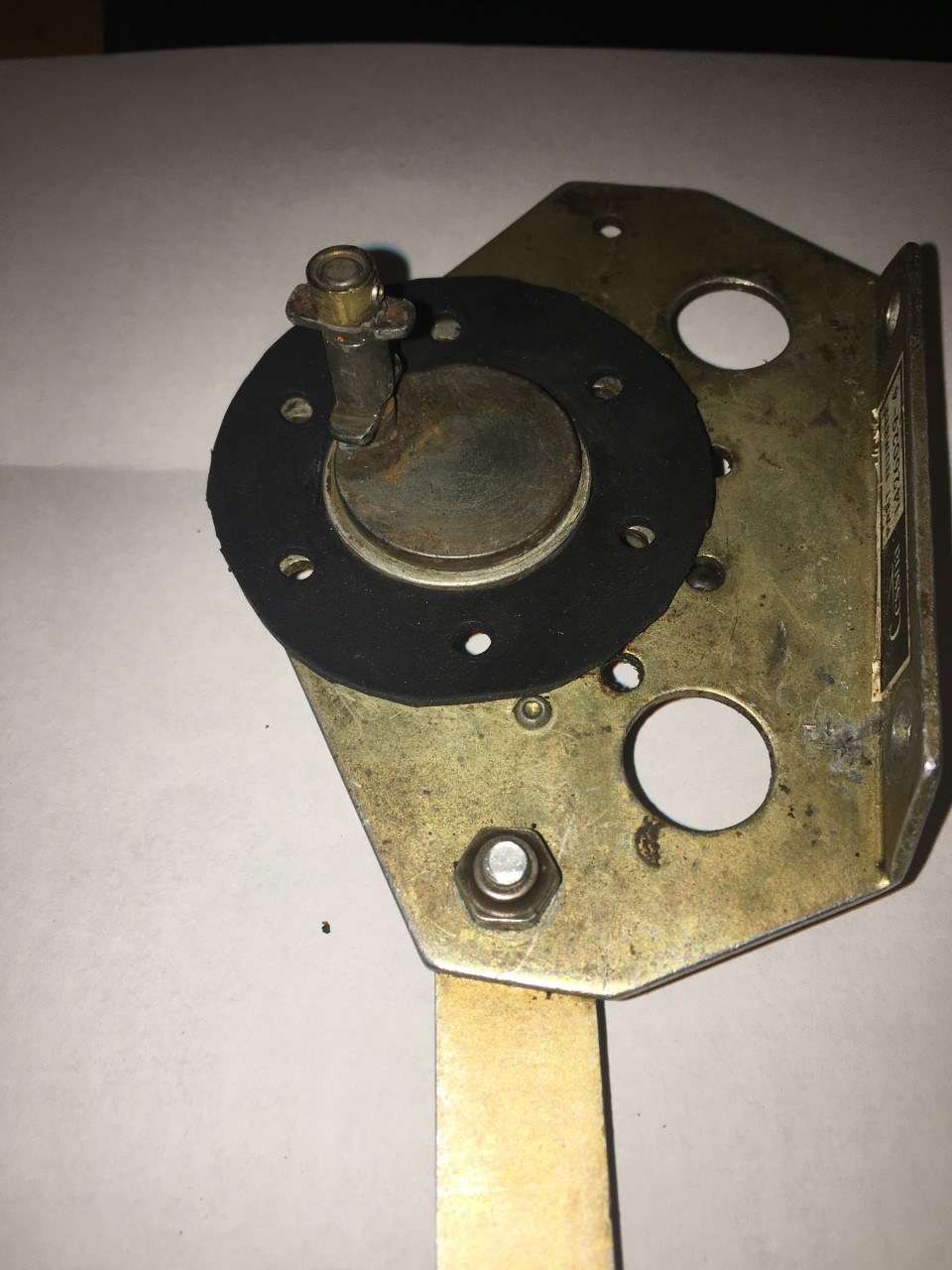

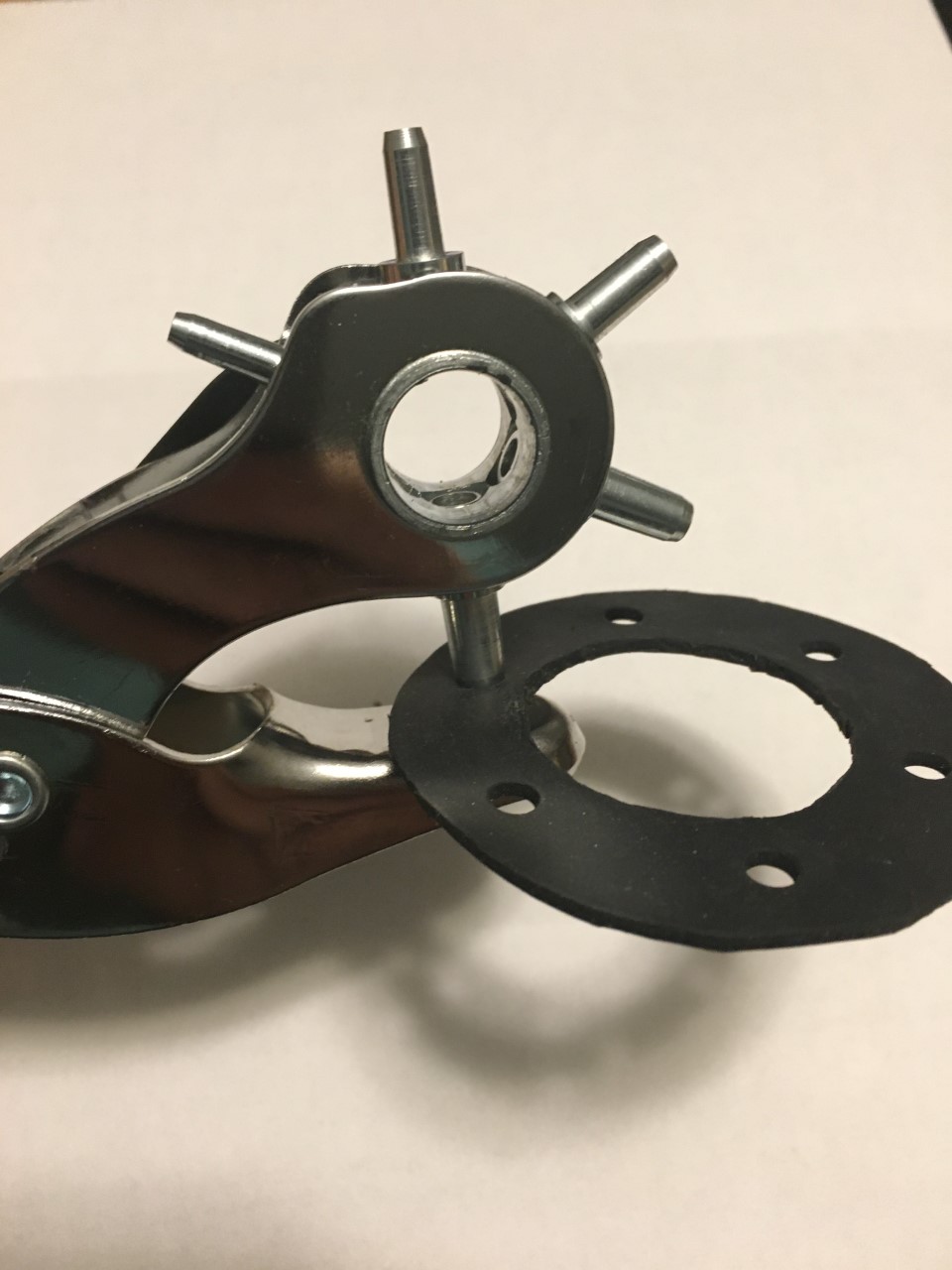

The inability to find a sealing gasket problem was resolved by simply tracing my original gasket on to some gasket material and cutting a duplicate and punching holes in it for the screws.

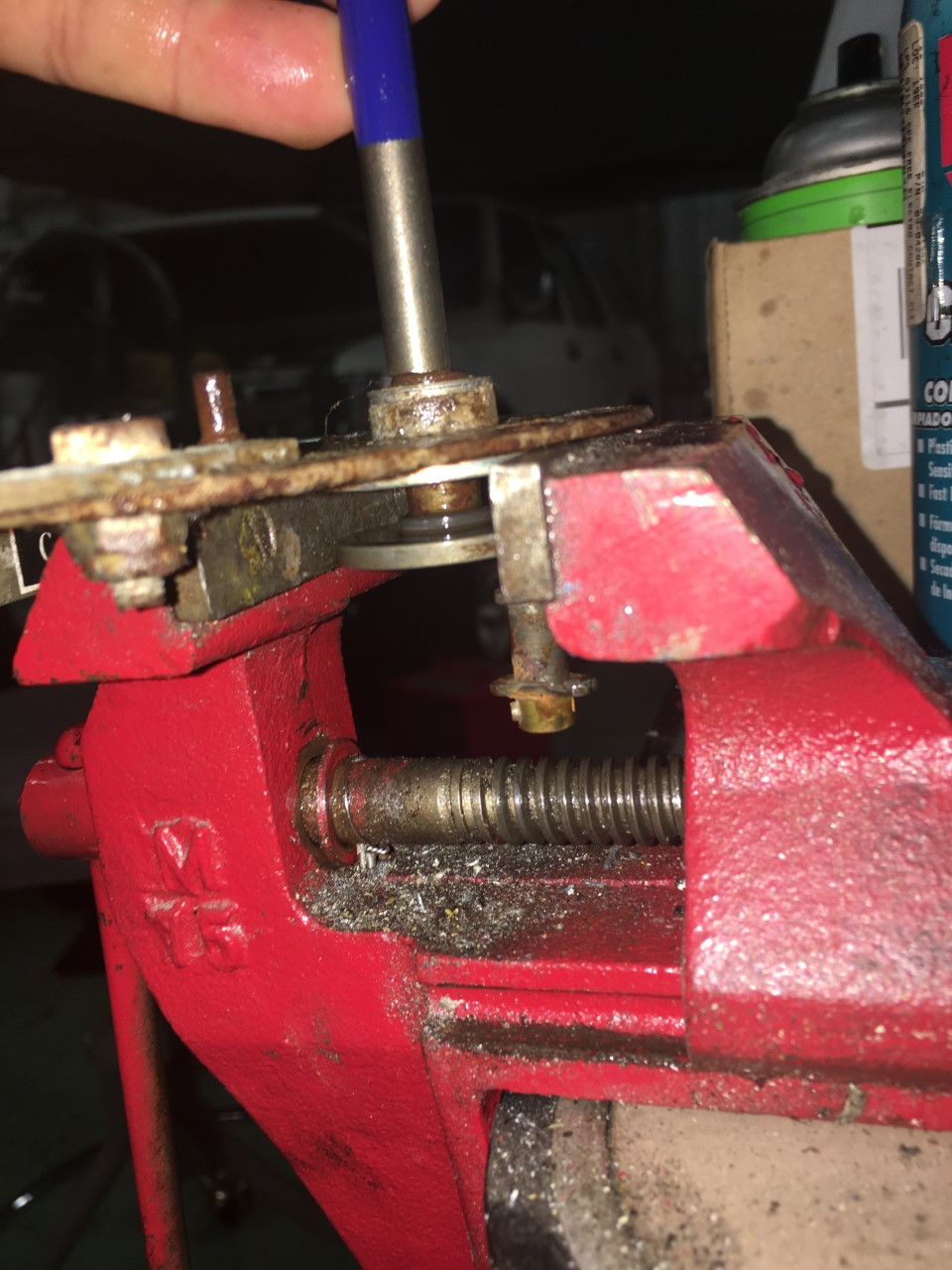

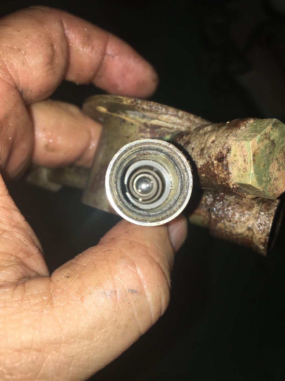

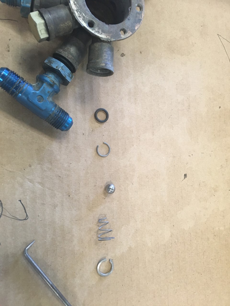

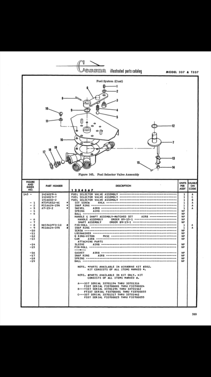

With care, the retaining rings for the springs and balls can be removed and reused and used a L-shaped pick to get the rings out. They can be "pressed" back in buy starting them by hand and using AN fitting to screw/press them all the way back down. Behind the balls, are the sealing o-rings. I measured and replaced. Be sure to use fuel resistant o-rings. The shaft of the selector also uses a fuel resistant o-ring. I cleaned this up and replaced o-ring, lubricated the shaft with aircraft grade fuel lube/grease (available aircraft spruce, etc). Reassembly was a snap. Punches were used to get the roll pins out and because autopsy valve was frozen, had to use a punch to get the selector with the cam out of the housing.

But...I had bought a viton o ring assortment from Harbor Freight for various uses on my 337 project. For the shaft there was a perfect fit out of that assortment but can't recall which compartment with the exact measurements. I wrote down the measurements of the original shaft o-ring as 0.5" OD x 0.4" ID x 0.05" CS (cross section). Realize that's the compressed old o-ring measurements. Nothing out of that assortment, though, fit the ports with the balls. I'm pretty sure those were 5/16" ID x 7/16" OD x 1/16" CS (cross section) that I purchased online from the o-ring store. Again, all in viton as the parts manual specifies. Sorry for being a little scattered on that now.

Just an update now about a year after my fuel valve rebuild. Only residual issue is that I cut the gasket for the valve from nitrile hoping to update the situation. (recall no one makes the gaskets for these valves anymore and one will have to be made from tracing the old one and raw materials).
I over tightened the nitrile making it squish out the sides some. This lead to the exposed part of the nitrile cracking. I am concerned that the cracking may migrate to the interior and lead to some leaking. So I am going to cut/replace the gaskets with new self made gaskets of gas proof carburetor material from the local auto store (a rubberized paper material; I think the original were cork).

O-ring size confirmed: 5/16 " ID x 7/16" OD x 1/16" cross section (CS)
Again, this is where the ball will press against the valve cavity port/o-ring to provide positive shut off. I used fuel resistant o-rings.
If you use a right angle pick and firmly pull, you can pull out the main retaining ring without damage for reuse. Might have to grind pick end short to fit. I pull it out while holding it down in a 5 gallon bucket so that when it "pops" the spring and ball don't go flying. It'll be a pretty strong tug. There will be another smaller retaining ring holding the o-ring in place. Retaining rings can be pushed in with screw driver and positioned. For the main ring, which can be stubborn, once past the first few threads can use an AN fitting to "press" it all the way down.
Used fuel resistant gasket material from auto part store to make valve body gaskets by tracing valve and old gasket. $9 leather punch from harbor freight to punch out screw holes. The material I got was thin so had to double it to get right thickness. First inspected valve operation visually after reassembly and then tested valve by blowing air through it before putting it back in.
