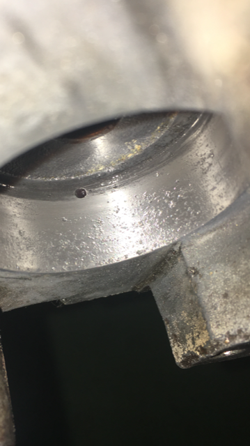

Oh so familiar that corroded look! I have been living in the zone. Mine were similar (but sorry not that bad).
I have attached a picture below.
I have been working on brakes for months and months. Felt it was so necessary for an event of engine out on take off, launch abort and emergency stop on remaining runway.

Very frustrated with all this work and persistent softness, so went over the system multiple times. As mshac points out check for leakage at the calipers. But here's the twist. I saw none. Until one day I braked hard and right after removed the shoes and pulled the calipers. There I saw a slight ooze from around the pistons that was not enough to to cause a drip outside of the assembled caliper but was not holding full pressure. Gummy residue confirmed oozing that on the hot brakes never led to an easily seen drip.
Closer exam on disassembly after some good cleaning showed what I call micro pitting in the cylinder wall that was letting the brake fluid ooze out past the new o-ring. (see attached photo). An unexpected corrosion induced complication. Tried smoothing the wall with 2000 grit till the pits were gone but appears this lead to larger bore, thousands of an inch oval shaped and did not stop the oozing; now oozing by a new issue-out of round and too large.
So, I gave up and headed for a pair of brake assemblies. Voila, lots of calls, very expensive and not available in our supply chain pandemic world.
After some thinking it dawned on me I can reuse all the parts of the original assemblies and just get new caliper cylinders. Discovered the hard way through parts ordering and returning, the cleveland application manual has incorrectness for our aircraft. Be sure to carefully look at their diagrams and make sure their diagram matches what is on your aircraft. I think I have something similar to a seneca setup in the end. Once again, supply chain and stock issues. Aircraft spruce had one cylinder in the their multiple warehouses. Chief Aircraft after a couple weeks was able to get the other cylinder drop shipped from cleveland brakes with notice another production run was a couple months off if anything else needed. At the time felt like I had the only 2 brake caliper cylinders in the world.
This seems to have solved my problem.
So take a close look at the cylinder wall and see of any if that micro pitting is there. Be aware of oozing that may not be outwardly visible. You do not have to get a whole brake assembly (unobtainium) but might be able to just get corroded component (less unobtainium?) at reduced price and reuse everything else. Test your brakes.
