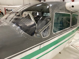

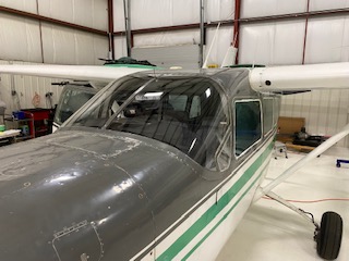

Windows done
I finally got the windshield and vent window done. It took longer than I expected as I kept getting redirected to other projects. We got the windows from Great Lakes.
Now to order the side windows!!
Steve

Unread 03-09-22, 07:22 PM
Looks great Steve!
Mine need to be done, but it will be a year from now.
Unread 03-09-22, 09:30 PM
Join Date: Apr 2019
Location: KLOU
Posts: 194
My gosh, that looks great!
