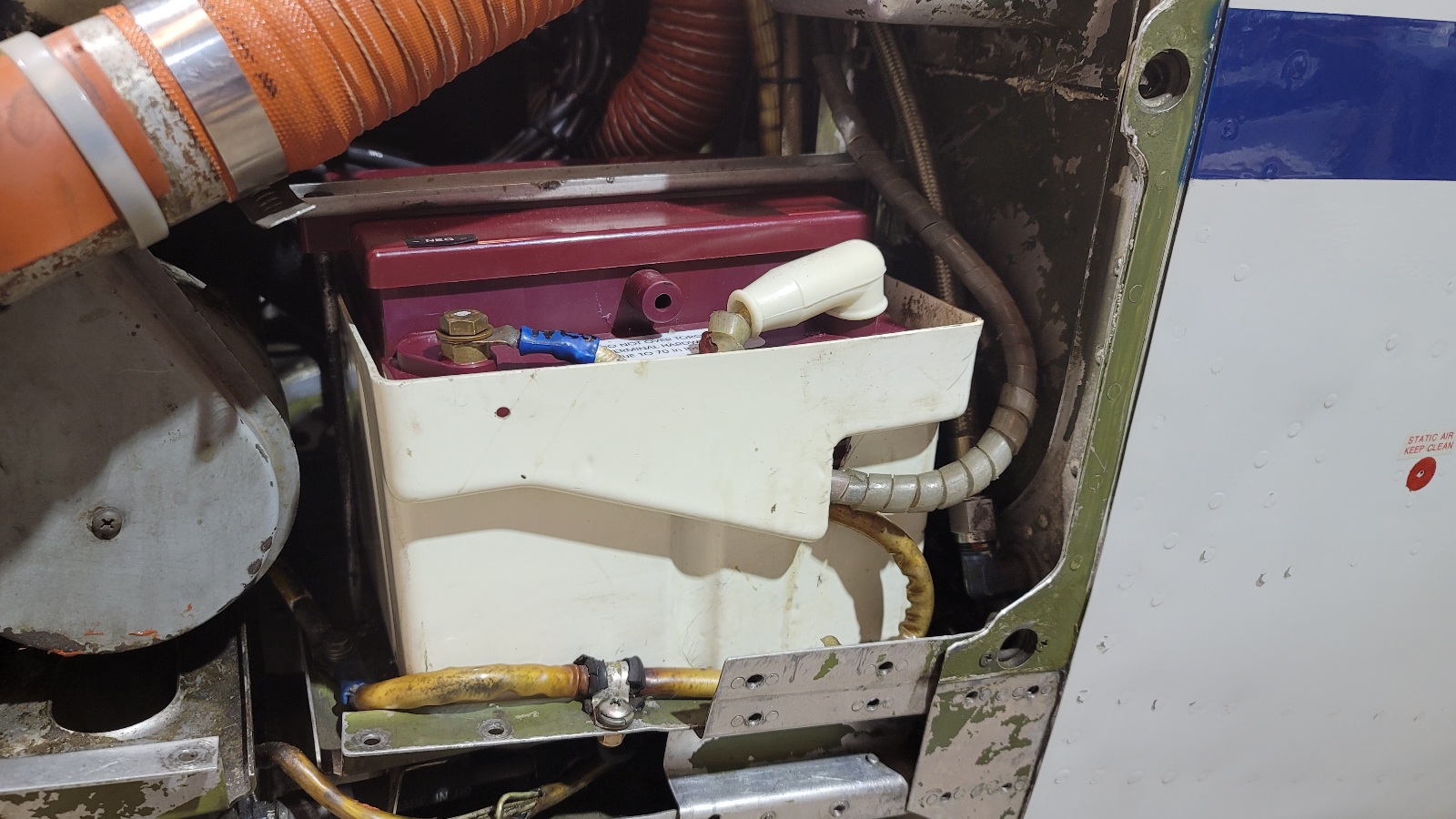

I can see where the design of the "M" battery could eliminate the hold town bar. However, this is what my installation currently looks like.

Diagram 140 in the parts manual shows those two bolts that go through the top brace above the battery:
AN3-63A
AN3-10A
The plastic piece on top of the M battery takes the place of 1470090-3.
So those two bolts, which are visible in your picture, go through the two holes on top of that plastic piece on top of the M battery
