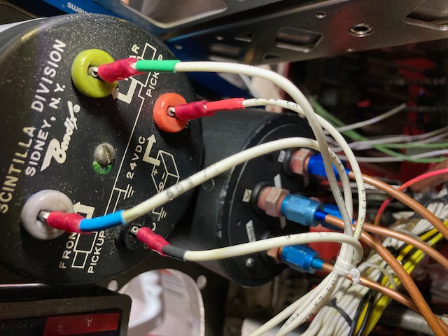

Hello: My wiring diagram covers 0001-0759 for the tachometer. The right rear mag has two wires for the tach K-EG5 is a ground wire and K-EG4 goes to the rear pickup terminal on the transmitter. This is mounted mid-ship to the pilot control column. The tach generates an ac signal you can read with your meter. The easiest thing to do is switch the front and rear pickup leads (K-EG4 and K-EG2) and see if the problem follows the wiring. Color-coding the wires at the transmitter and tachometer will help keep it all sorted out.

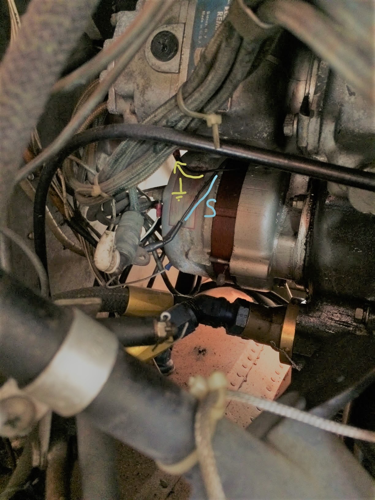

Tom,
Maybe this helps (I just changed my rear pick-up this weekend). The wires should come off the mag on starboard side of aircraft - it is the vent hole on the half of the mag closest to the engine, inboard (between the two mags). The ground wire (yellow in the picture) likely goes to a screw in the cover of the same mag, on a small terminal end. The signal wire should come down over the alternator and into the bundle on the firewall (blue in my picture). Sorry about this picture - it is not from this weekend, but rather a very old picture from when I started taking this aircraft apart to rehab it. There is likely one of the Cessna quick disconnects on the signal wire into the bundle.
My tach initially was working, then one day it swung wildly, then a few day later it just gave up. I trouble shot all the easy things first, swapped leads at gauge to see if it was gauge, changed out the box...finally, checked the wiring from the sensor/pick-up. Only thing left was the pick-up. Yes, it is tough to get your hands in there. I went through the left side cowl, and I had the top cowl removed as well as I was doing other work (i advise to do the same. I removed the starter - and disconnected the wires, and fed them up into the area between the mags. I used a stubby 3/4 box end wrench (fed the wires through the box end) and you have just a enough room with the wrench facing fwd, to slide it in and your hand, and was able to get on the sensor and break it free. Do the opposite if you have to reinstall new one. I tried a bunch of other methods, but that seemed the easiest. Could probably remove the vacuum pump to make it easier...but I was lazy at this point. You know what the real pisser is? First flight after the annual yesterday, and my rear vacuum pump failed. So now I have to go and remove that bugger tomorrow anyway. So, my final advice for you is - if you are going to have replace that pick-up for the tach, honestly, buy a new vacuum pump and change it at the same time!!! I am totally serious.

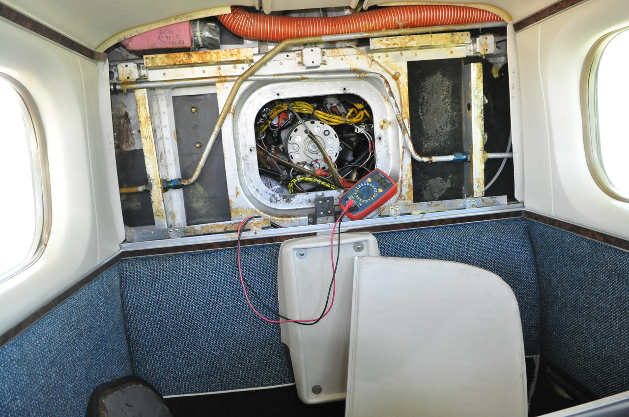

Tom, if you have the removable engine access hatch on the rear cabin wall, you'd be crazy not to use it. I had to replace my alternator (twice), and I can't imagine doing the job without the access hatch.
I've heard stories of A&P mechanics struggling and cursing to reach something on the rear engine accessory case, then billing (in at least one case) 14 hours labor to replace a mag! All because THEY DIDN'T KNOW THE ACCESS HATCH EXISTED!!!
If you have one, USE IT! All later 337's had it, and there is an STC to add it to early airframes that didn't have it from the factory.

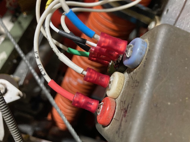

Problem solved!
Thanks to all the input I was able to solve the problem. It was indeed a broken ground wire - see attached picture. Put new terminal on it and reconnected to the mag and the tach works again.
