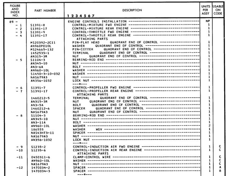

Control Quadrant Clevis Pin Part Number?
Looks like some past “improvising” was done.
I looked in parts manual but they dont include this pin in any diagrams that i can see.
I want to make sure to install the correct part number.
Any idea? 337B
https://ibb.co/6sK6dsw
https://ibb.co/NsKc2XD
337B

Smile Control Quadrant Clevis Pin Part Number?
J.
The bolt may seem to be incorrect but it's not. Fig 89/Item 8 Rear prop, Quad end. ATTACHING PARTS: AN 3-11A Bolt, NAS 679A3 Nut, NAS 43HT3-11 Spacer.
Hope this helps.
Regards.
BILLS
'65 C337

Bills,
In my fig 89/8 it shows the connection on the engine and not the control quadrant.
Is yours different?
https://ibb.co/xXzqh6k
https://ibb.co/JH7tSGH
337B
Philadelphia PA

Question Control Quadrant Clevis Pin Part Number?
J. Sorry your skymaster must be newer than mine. But the same info for the rear prop should be the same, just different Fig/Item number.

JHogan,
Your quadrant hardware is correct - bolts with spacers and nuts on the prop controls. My 66 has the same set up. Figure 89, item 7, has the listing for the hardware for the prop control, says "QUADRANT END OF CONTROL".

Thanks guys.
It Just didnt look right to me.
Looks to me like some type of factory work around to avoid the rudder trim chain.
Makes sense now 👍

I received an email from textron today with photos from their magic cessna books if anyone wants to see attached photos
https://ibb.co/J2xKLkz
https://ibb.co/7KFzNXb
https://ibb.co/JFd3d3Z

https://www.wagaero.com/hardware/cle...0392-2c11.html
MS20392-2C11
