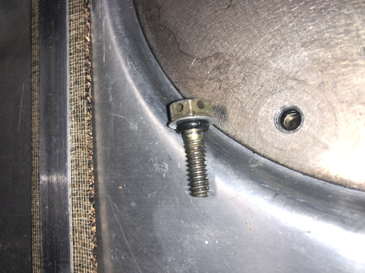

Here is how I have sealed mine. New viton gasket underneath the plate, I used a piloted 3/16 60 degree countersink on the 6 holes, and used a viton oring on the bolt under the thin washer to eliminate leaks caused by the thin cork gasket under the washer.
