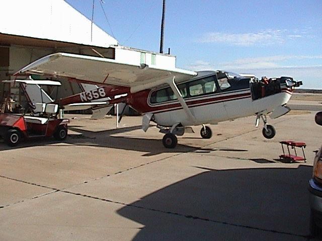

This works real well when working in the area of your nose gear.
The plane is over-center setting on the PVC legs, with a safty strap over the boom down to the golf cart. If you need to know how to unlock the nose gear so you can swing it up by hand, just ask.

Howdy fred: i just use gear switch to raise gear when its tipped on tail. The mains stay put. how do you unlock? JCH

Master on, gear lever up, extend handle out and pump 3 or 4 times. That will unlock it and it will swing by hand.

hey fred: makes sense. our 73 p has electric and it comes up with switch. sky king tells me i may be damaging boom by pulling down. weight wise its not much pressure getting her tipped back and usually done to inspect/ check gear operation. this may pose less risky than a jack incident . thanks for the picture. likewise glad to know others check their gear operation via boom. jch

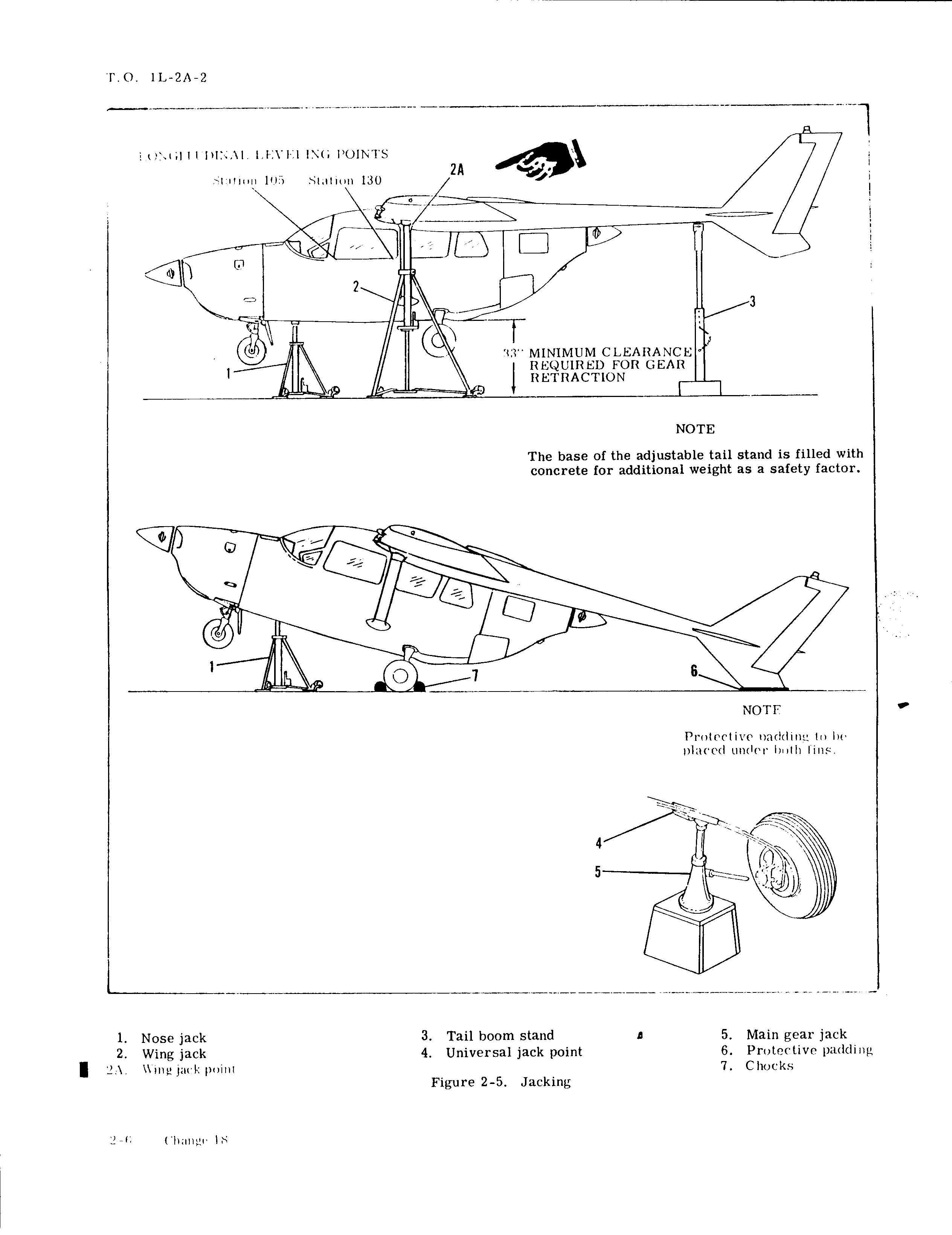

Here's the diagram that goes with the written instructions.
