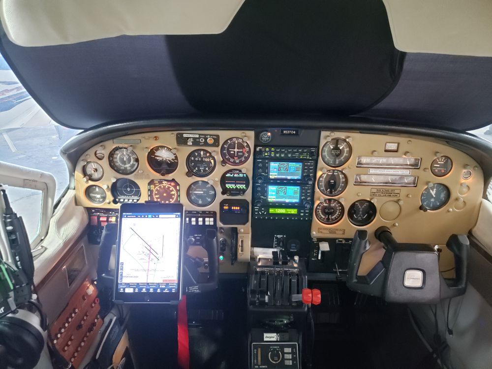

iPad Mini
I am using an iPad mini with a ram mount - sits right in the middle of the yoke, just a little off-center to the right so it does not impede the left hand on the yoke. I will attach a photo later this week so you can see. I went with the mini so that I would not have the tablet block out any switches or instruments, but a full size iPad would work as well - I am just a little particular.

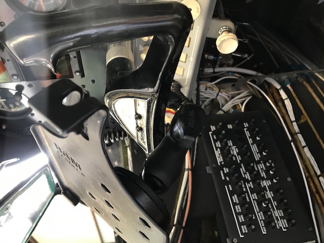

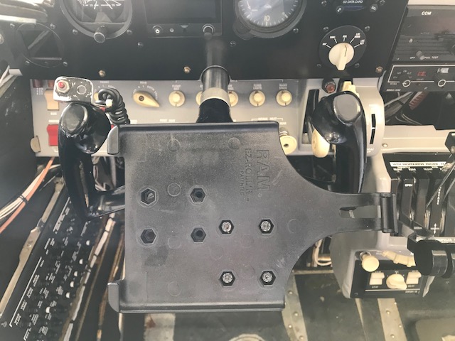

Pics
Here is my iPad Mini set up on the yoke.

Be careful when you attach the yoke mount to the yoke torque tube. The Skymaster yokes push farther into the panel than some other Cessnas. It's possible to smash the mount into the panel and hit/bend/break important stuff.
Looks like my plane's previous owner found this out the hard way. The DG knob shaft is bent.
Unread 06-14-20, 05:18 PM
I use an iPad Mini 4 oriented in portrait rather than landscape, which matches the route of flight and charts better. The following RAM components are all size "B"; the prices are MSRP.
  • RAM-B-202-AP20U iPad Mini4 mount ($24)
  • RAP B-200-2U Double Socket Swivel ($25)
  • RAM B-121BU Yoke Clamp Base with Ball ($26)
I move this across several Cessna aircraft that I fly regularly; 172, 182, 210 plus my 337.
With the Mini's smaller profile, I have no trouble seeing anything on the panel. I have full access to the electric trim, and the factory autopilot and trim disconnect switch inside the control "horn" yokes. See the attached image.
As a note, I bought a factory sealed Mini4 128GB on eBay for less than $250, specifically for ForeFlight use. It has plenty of horsepower and storage space.
