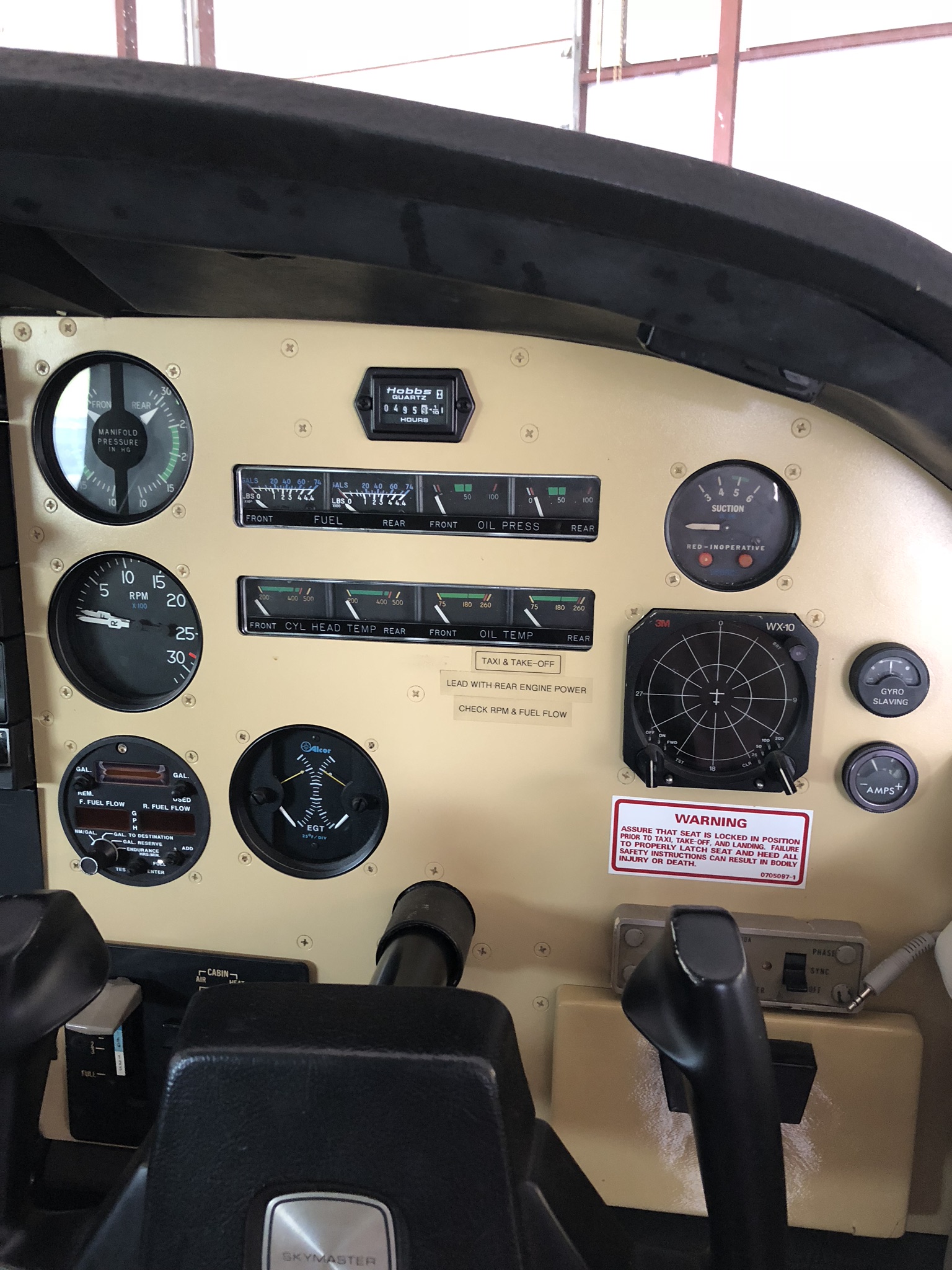

I was thinking of putting the 830’s where the current MAP gauge is and my current FF gauge is. I’d probably move the FF to where the EGT gauge is and just not have the current EGT, MAP & RPM gauges and just use the 830 for that info.

You have had some nice panel work done and certainly have some additional real estate in the panel. I think you better review the STC for the 830’s. Near as I can tell, it is only approved to replace your EGT and CHT - you still have to maintain your original MAP, RPM FF, oil temp etc... This is why the cost is so low - if you want to replace all those you would have to with the 960.
In your case though, you would still have room to install the 830’s side by side where the EGT gauge is and to the right. Nice looking panel!
