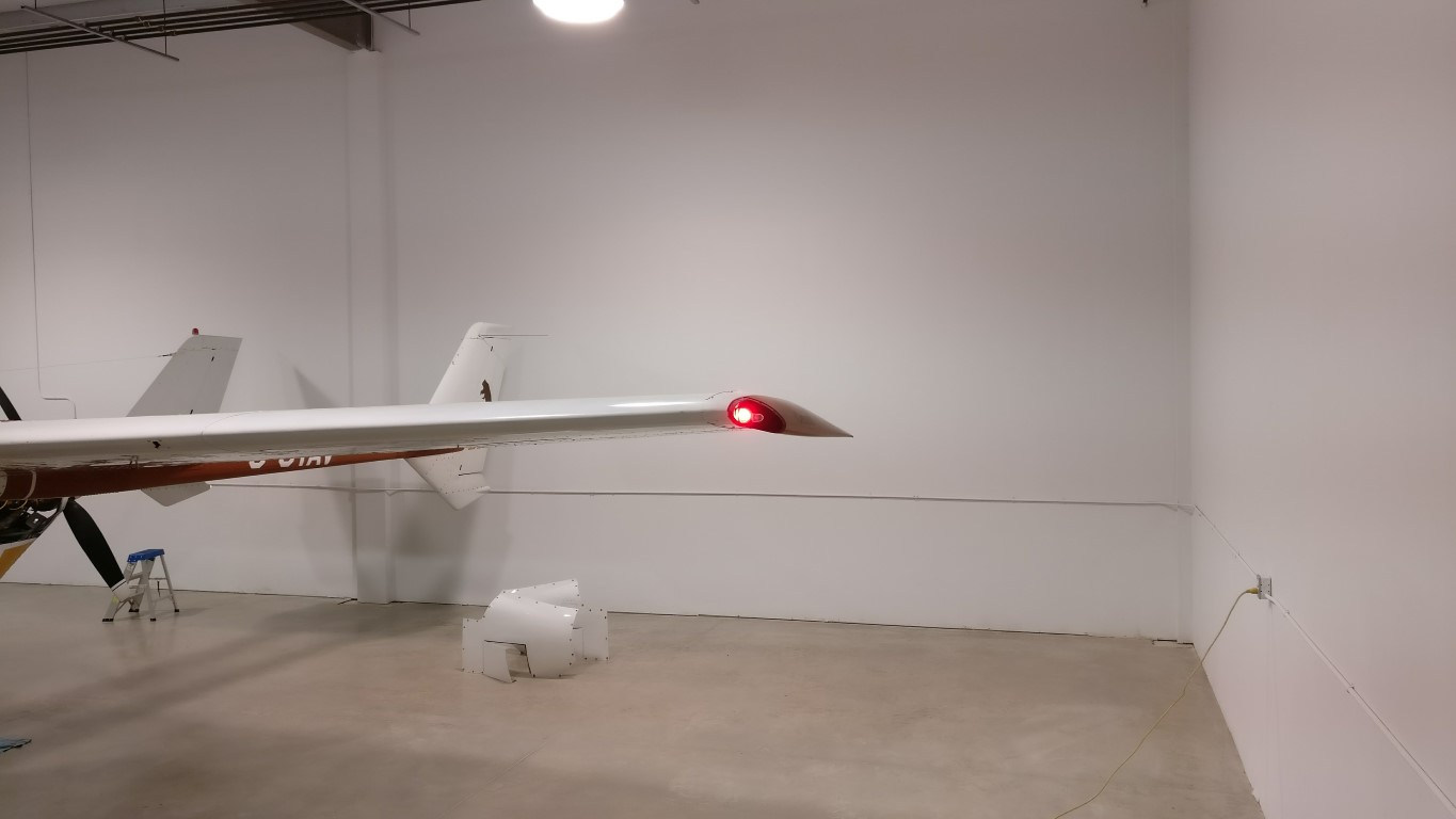

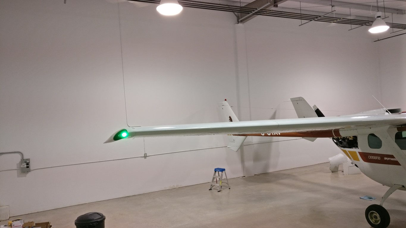

Transitioned from non-strobing incandescent to strobing LED. Difference is insane; really happy with results. Installed clear lenses at the same time. These aren't STC'd so you have to be comfortable with a "changed light bulb" log entry.
My new wingtip lenses just arrived from Great Lakes Aero so that will be the next project.

Long/short story...they're the latest version of the NavStrobe Sextant brand that Aircraft Spruce sells for $450USD. Except that guy on Beechtalk thought that Spruce were being a little hefty with the markup so he tracked down the supplier and bought in bulk for his buddies on the ramp. He had a few sets leftover that he posted for sale on BT and it caught on quickly.
He recently got the latest 40w design and I sprang for a pair. It was $100USD including USPS priority shipping to Canada. It didn't include the clear lenses so I bought a pair of those from Spruce for about $15USD each.
Nice guy and the product seems great.
I've also got an LED T10 wedge rear position light coming directly from NavStrobe and some 28v maplights from LedTronics specifically designed for aircraft coming shortly. I'll do threads on those when they arrive.
