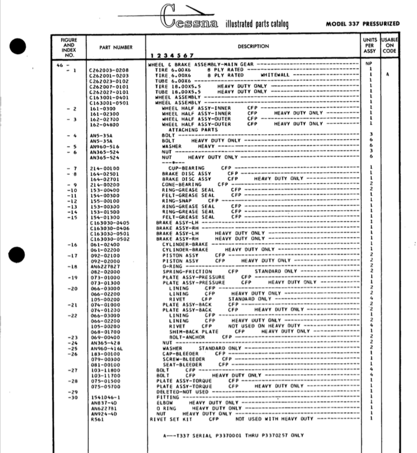

Does anyone know what the Cleveland Model number is for the Heavy Duty Brakes on a 1973 P 337G??
Jim Bennon
Unread 01-14-15, 09:44 PM
James
Are you just looking for replacement brake pads??? Item 20 and 21 in the attachment are the linings #066-02200
In the Parts Catalog it refers to HD Brake Assy C163030-0501 and the Disc 164-02701
Not sure if these are Cleveland ??
Yingling shows the Assy at $2200.00 New #30-69B

Hi Herb,
Actually what I am looking for is the correct part number for the insulating shim that as far as I can tell is not listed or shown in the Cessna Part book.

I show the shim back plate as Cessna part number 068-01700 if that is what your looking for?

Posts: 58
That confirms with what I just found---thanks for you help Gentlemen!!
