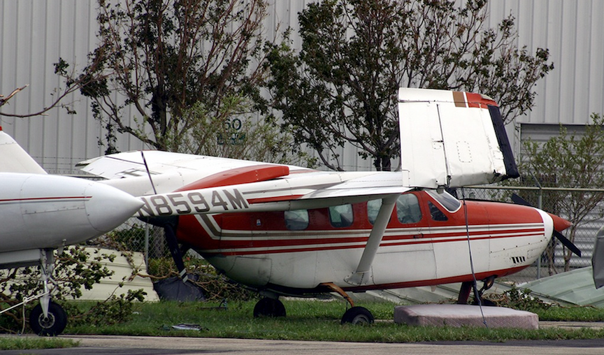

Posts: 2,286
Not the first issue
Hurricane Wilma in 2005
Number 6 in the P line - early

Unread 02-26-13, 03:42 PM
bjherron bjherron is offline
Join Date: Feb 2012
Location: Ann Arbor, MI
Posts: 30
bjherron is on a distinguished road
interesting how it looks like that same section of wing is broken off underwater.
