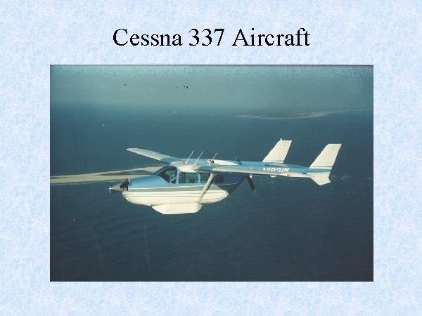

Well it looks like the gov did it to us again... cont engine did the following.. put the enigne in a skymaster.. did taxi testing and then a high speed run... and then quit... yep.. put the thing back on the shelf for the time being... according to NASA... so it looks like they are not really going into production with the thing after all the money the goverment put into it...

Unhappy another shot of their skymaster
here is their skymaster... that was we belive used at the airport at mobile

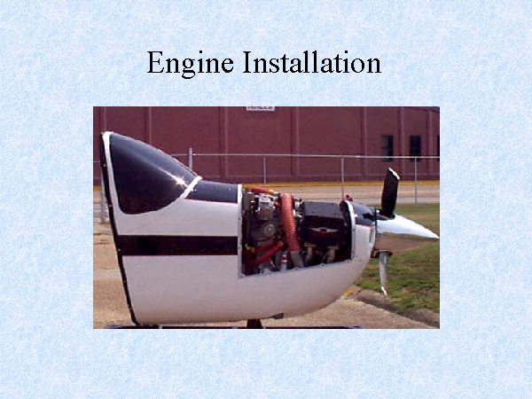

Angry GAP engine fills engine compartment
And you thought your engine takes up all the room in the compartment... look carefuly at the GAP engine and how much room it took.... I still think that LYC once it gets over its metal problems has a better engine in the 540... but, we are looking for a better engine still...

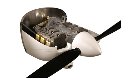

by the way franklin has a 220 hp engine now... smile wanta see it... guess how much.. new.. less than 15K... no exchange..

it's just like them, ya know. No vision, except to spend other peoples money (could be a catchy title for a film).
Franklin, with a super charger, now that would be a really neat thing. What kind of plane was that picture on. I read the article in EAA about those guys in LasVegas that put a supercharger on the cont 540. Belt drive for the supercharger and the alternator. Gets rid of lots of problems for the alternator. Supercharger does less heat for the intake, and makes exhaust much simpler than the turbo exhaust.
