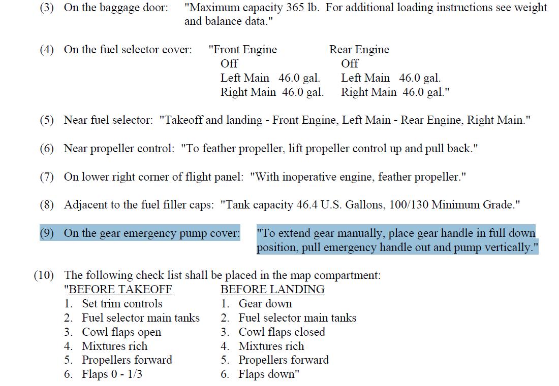

Hello everyone,
I'm having my instrument panel redone and have had several of the plastic panels repainted. The panel that covers up the emergency gear handle well has already been painted, but I didn't get a good picture of it before it was painted. I believe there was some directions or writting on the panel, but can't remember what was on it before it was painted. My guess it was directions on how to use the panel. I have a 1966 337A, could someone with a similar aircraft tell me if there was writing there and what it said. I can have it silk screen on. Thanks,
Karl
Unread 05-23-11, 10:27 PM
Tony
As per C337 Type Certificate, see attachment
Unread 05-23-11, 10:37 PM
Tony
C337 type certificate
see note 2, pg 27 of 48.

Thanks Tony,
I knew there was some writing there.
