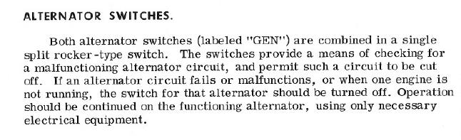

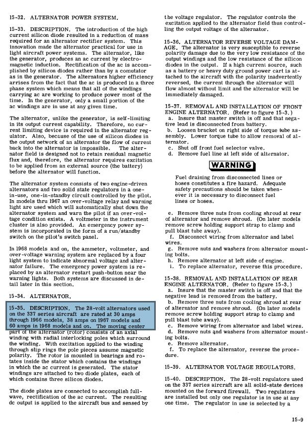

Your aircraft came with 30 amp alternators and the switches were labeled gen.
