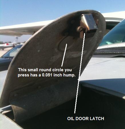

Anyhow, I was looking for a KM610-51, which is the latch assembly that opens the oil dip stick door on the cowlings (see pic below). My go-to guy, Don Nieser at Commodore, was not answering the phones. Lone Star has it for $94 (www.lonestaraero.com/pm-2132-45-km610-51.aspx). Yingling quoted at $51.
For a small latch. Highway robbery.
So I kept at it. Googled the part number and found a message board thread on experimental aircraft entitled "Where to buy oil door latches (KM610-64)?" and citing B&B Aircraft Supplies as an inexpensive source. I called them, and yes they have new-surplus units in stock, but not the -51, just the -32. I'm about to hang up when the guy explains that the only difference is the little hump that potrudes through the hole in the door -- 0.032 inches on the -32 and 0.051 on the -51 (see pic below). In short, it will work fine. I ask the price and he says $10. I order 2.

Another one failed!
Within days of one failing, another of the latches has failed (the spring disintegrates). So I've ordered 2 more of the KM610-32 from B&B (913-884-5930). I mention it because if yours is near the age of my 1973 337G -- or older -- one of yours may be near failure and you may want to have a spare or two around, especially at this price.
