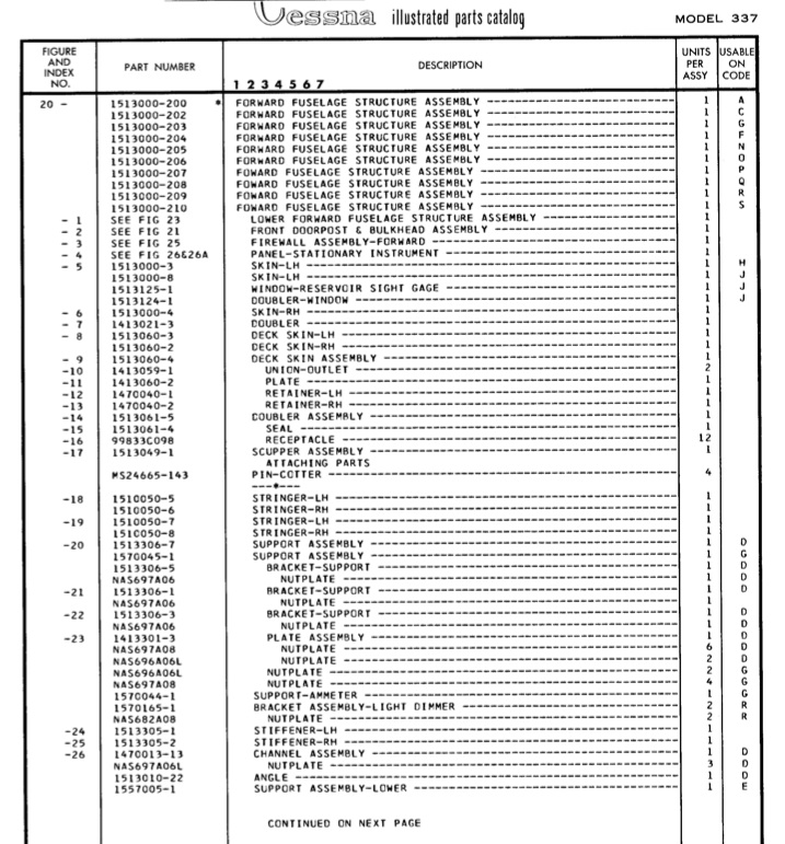

I am looking for a plastic tray that fits below the instrument access panel cover on the top of the front cowling between the firewall and the windshield. This plastic tray helps keep water off the instruments. Does anyone have one of these for sale or know where I can get one? I have a 1971 337F model. Thanks. Ricky

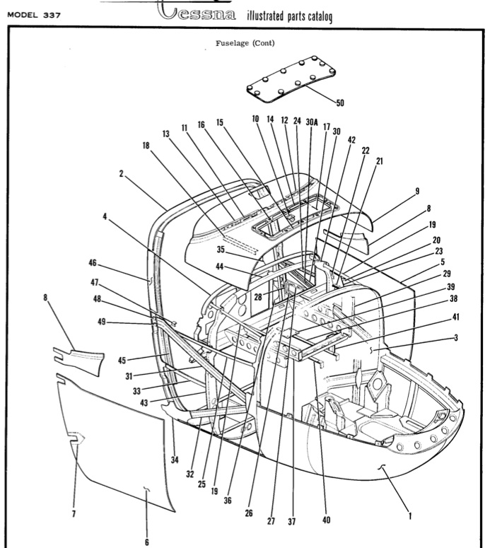

The part you want is #17 on the illustration. This is from CessnaParts.com (ouch)!!!
1513049-1 SCOOP
(List Price: $ 310.41) Call for Availability $ 248.33 (EA)
You should buy the seal also #15. This gets torn up from working in the radio bay. Don't just rely on the tray for the moisture, you should try to keep the moisture from intruding from the start and the tray is there for insurance.
