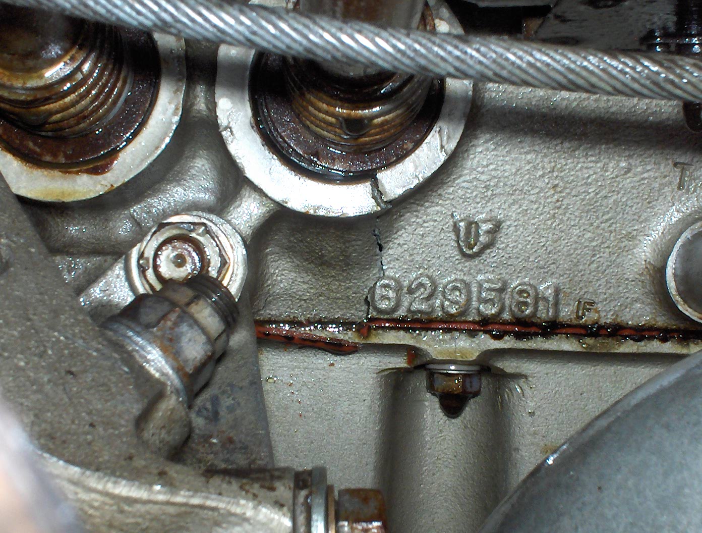

Attached is a pic of the crack in the case.
The flange on the crankshaft (that was replaced according to the logs in 2005) shows a serial number stamped on it - that makes it a VAR crankshaft, right?

Unread 12-26-07, 10:40 PM
That case is not repairable, sorry. That is considered in a critical area.

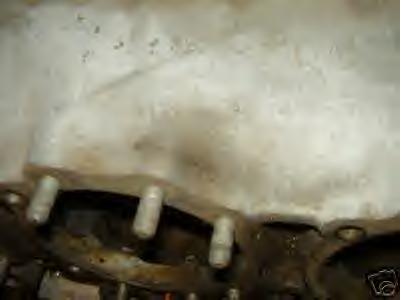

How about this crack? Would it be repairable?
Just above where the cylinder mates the case. It is the longer black line, running diagonally.
