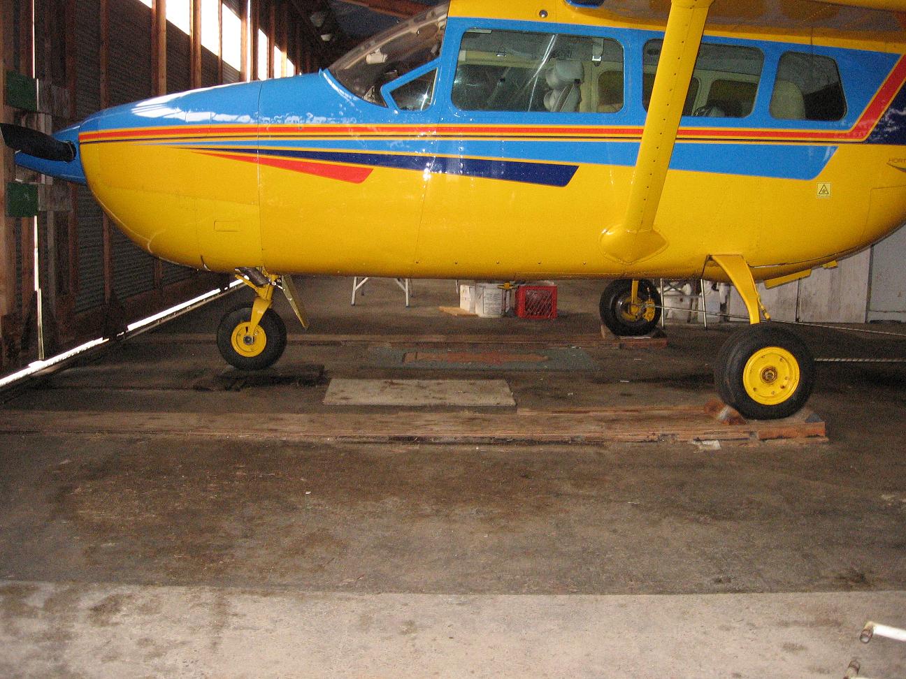

Hangar Ramp/Winch System
Here is the ramp/winch system that I built
1) Build ramp so aircraft will roll out and be winched in

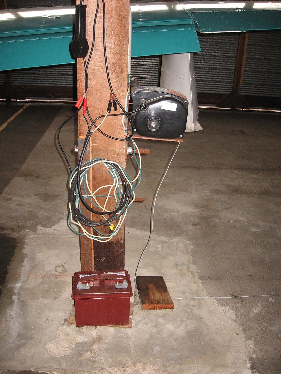

Unread 12-16-07, 04:24 PM
Frank Benvin's Avatar
You can use a 12 volt boat winch . Down fall is that you will have to keep battery charged. It comes with a handle so you can manually winch the plane in

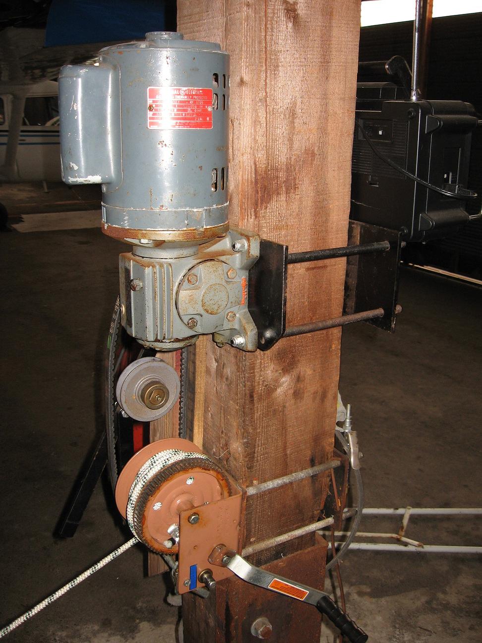

Unread 12-16-07, 04:28 PM
I took a 110 volt gear motor and put a pully on it. Then I took a boat winch and extended the shaft and put a pully on it and made a tension arm with pully to connected the two. I can use the gear motor or if the power goes out I can mannully winch the plane in

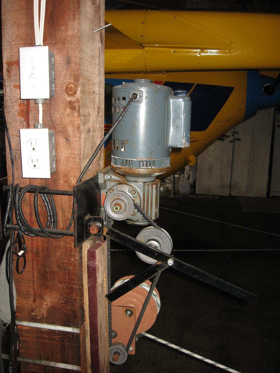

Unread 12-16-07, 04:30 PM
Here is the other side

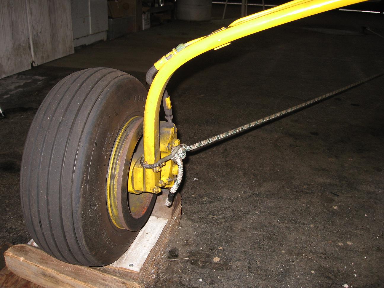

Unread 12-16-07, 04:31 PM
Gear leg hooks

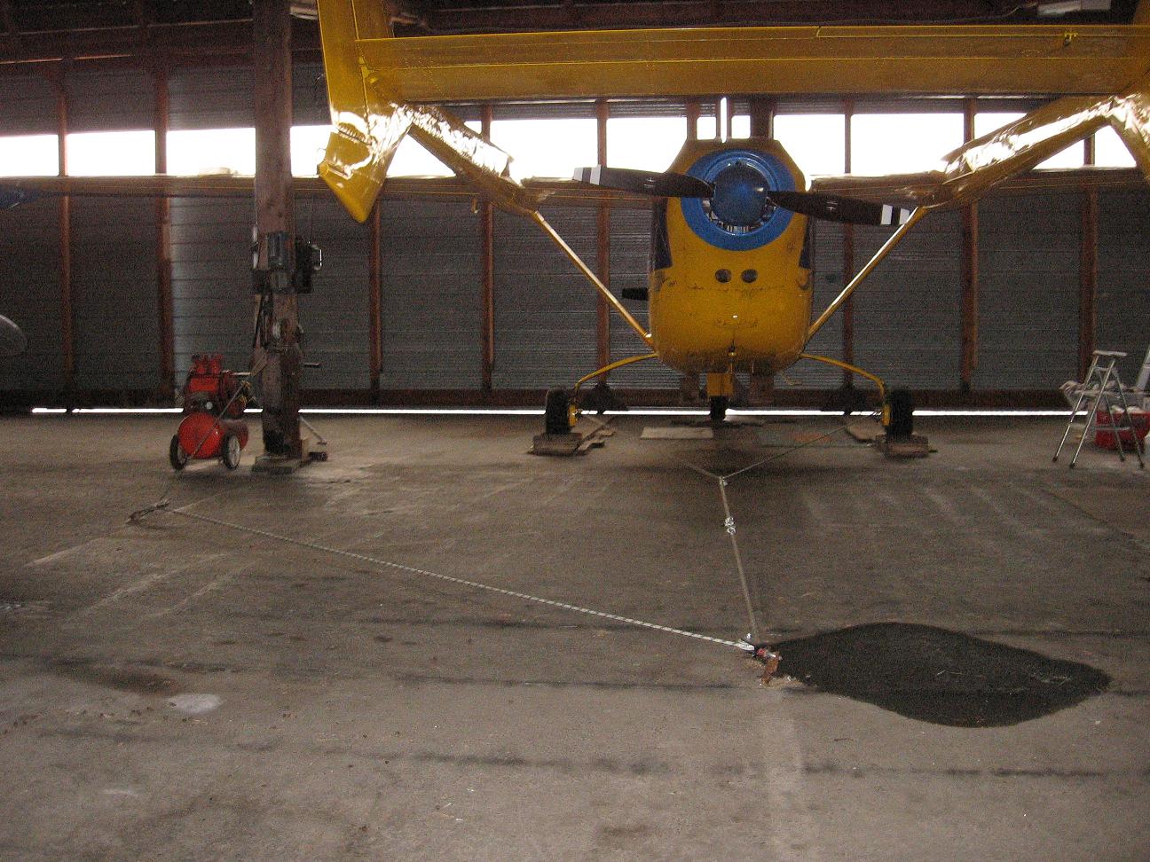

Unread 12-16-07, 04:32 PM
How i ran the rope from the plane to the winch

Unread 12-17-07, 10:43 PM
It looks good. How do you remove the chocks, to let the plane roll out?
Unread 12-17-07, 11:40 PM
First I hook up my tow bar. If I have someone with me which is 99% of the time I have them remove the last chock. If not I remove it myself. Make the first foot of the ramp has a slight incline then increase it after that. The plane rolls forward very very slowly and I walk to the front and grab the tow bar and guide it out.
