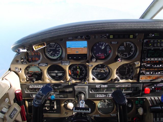

Still working on an approval. I don't think most avionics shops will tell you that a referance only will work. I've done it a few ways. Just know what you are doing before you venture into installing instruments that are "unapproved". If you do install one for referance only.... I can tell you. You won't use if for referance after the first 30min. Your originals will fade in the background. The Dynon EFIS has made managing the flight so easy, and so much more enjoyable..... Here's a picture of the new panel as soon as I couple the autopilot to the EFIS.

Jose L. Ichaso Jose L. Ichaso is offline
Location: Barcelona, Venezuela.
Posts: 48
Jose L. Ichaso is an unknown quantity at this point

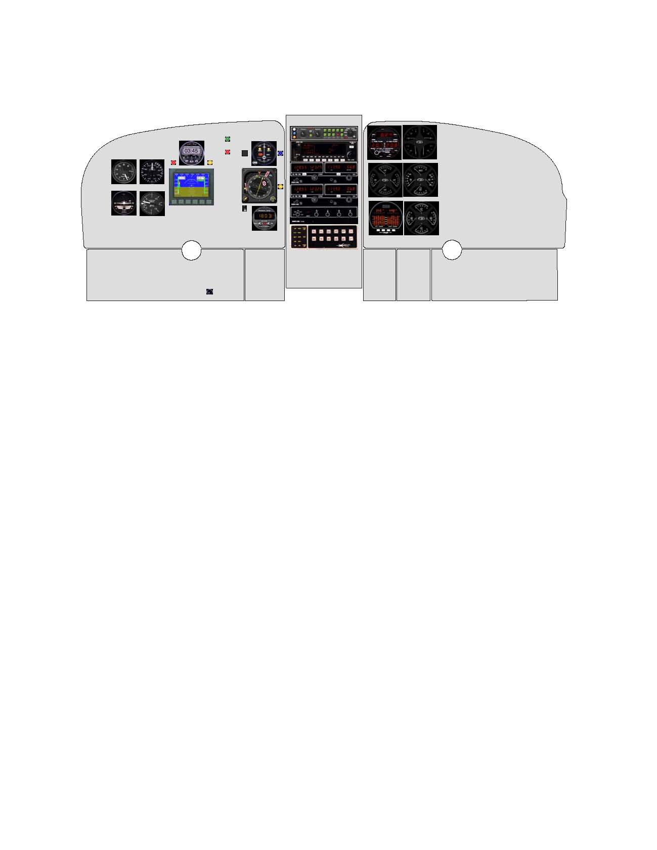

Nice panel Richard!, there is a very nice and cheap EFIS from Blue mountain avionics, that cost about $2400 and is battery backup. Here is attach a picture from a friend of mine's Seneca II, from the Blue mountain webpage.http://www.bluemountainavionics.com/elitesupport.php

what is really amazing is the pricing.
I looked at replacing my old HSI, earlier this year, and the price for the unit, installed was over $15K. That's no GPS, just a slaved HSI.
These things, when you look at the picture of the Seneca, are more useful, and substantially cheaper. I wonder what installation costs were for the Seneca. Was it done under a 337?? Must have been, because these are not certified units. No STC's. Wow. I really like the little unit in the Seneca. I could use that.
