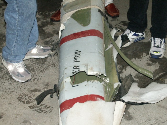

If you had gone to the OKC fly-in you would have seen a boom that had a tail strick in Don's hanger. It almost cut one of the booms in two, but the plane made to to a save landing. Don can give you more detail.

Fred, First of all the only time I ever heard of a prop cutting one of the booms is when I saw the boom in Don's hangar. If I recall correctly it was from a military 02 Skymaster...not sure though.

If you look at the free space below and on top of both booms, even if a prop were to leave the hub, the chances of a boom strike are really really small. The boom strike that Don has in his hangar was not a full strike but instead a partial hit on the bottom side of the boom. Hope this helps you out.

Edrapp, If you want to e-mail or call me I can give you all the details about the aircraft I have that had the boom strike. Yes it was an 0-2A, but the good thing is that Cessna built a very strong aircraft in the 337/0-2. More than 50% of the boom was torn away. The structure of the 0-2A boom is exactly the same as the boom structure in all 337 aircraft. Also, I have a pressurized 337 for sale.

Here's a picture of that boom. You can see about half of it is gone, but as everyone has pointed out, the plane landed safely

Get in touch with Don Nieser at Commodore in OKC, he can tell you some stories on this subject. We have a tail boom from an O2 that was hit by a prop. There are many stories on line about battle damage on the O2 during Vietnam. The O2 can take a direct hit from 37mm flak and still make it back to base. If you would like to see a picture of the type of damage that may happen, just let me know. We at Commodore can also help with all your part needs/maintenance.
