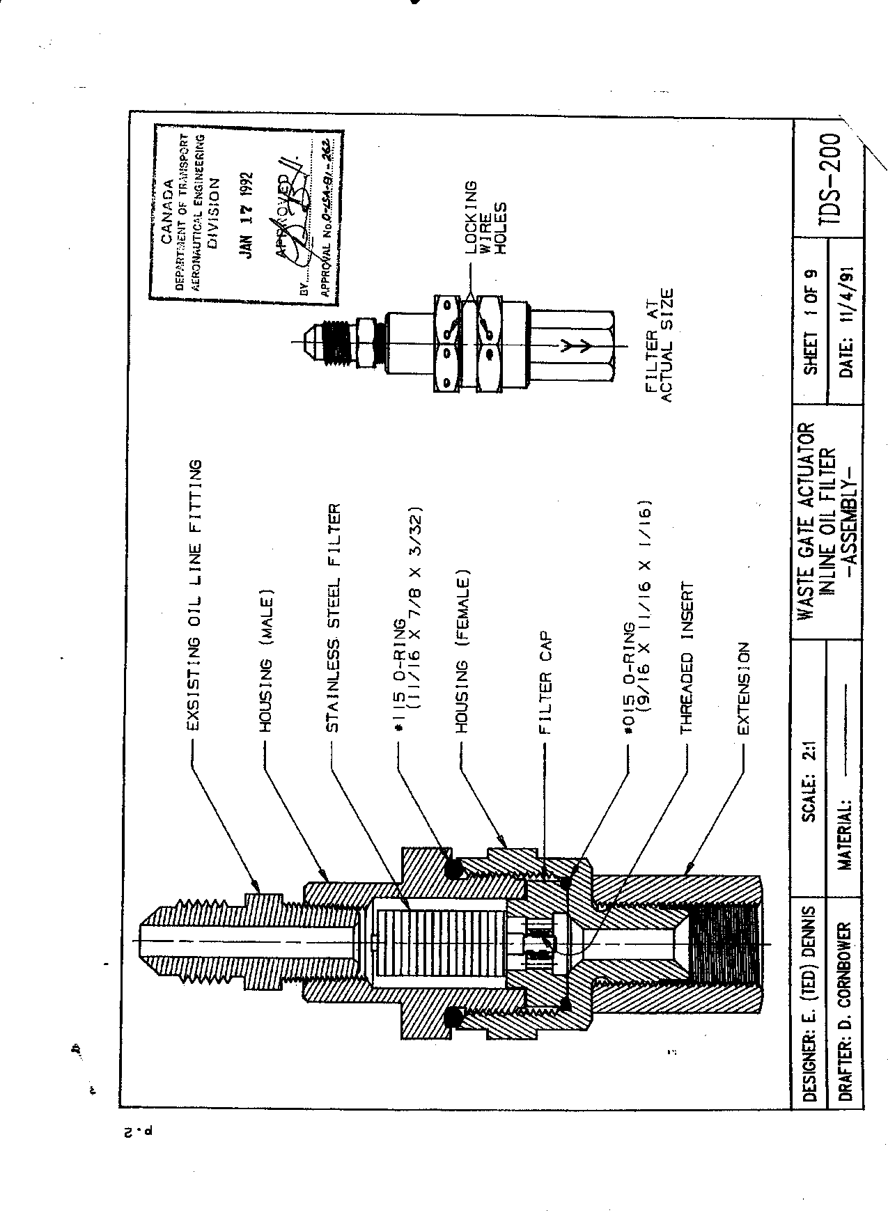

wastegate actuator inline filter
my 73p has theese and it works. I never had a problem. previous owner was a canadian who had caa approval. i have all drawings and would share. plans and approvals. James 409.770.4341 or jhenderson14@houston.rr.com
Unread 05-02-04, 10:56 AM
nice drawing -but what is it's purpose?
Unread 05-04-04, 09:13 AM
Location: galveston
Posts: 126
unfiltered oil
damages and causes stuck waste gates leading to premature turbo overhaul.
