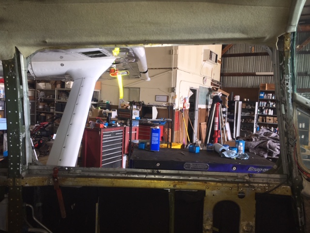

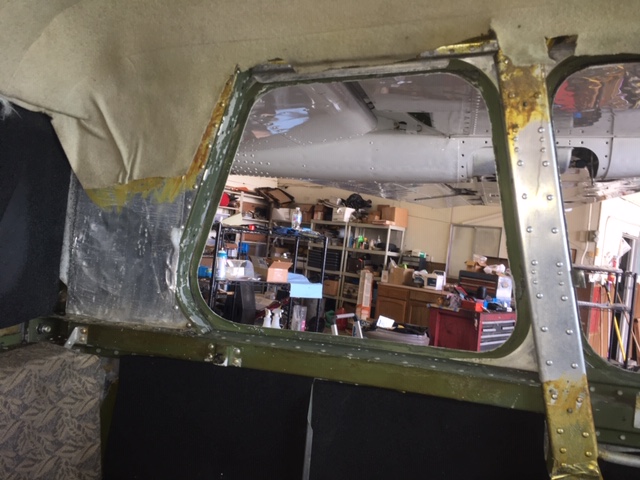

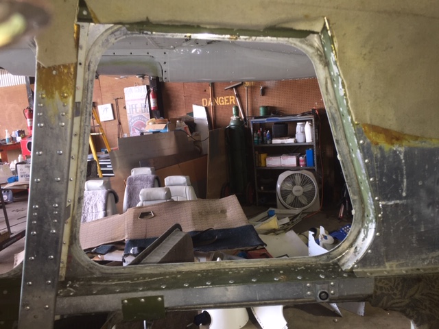

New side windows going in....at last!
So far the side windows came out by de-riveting just between the rear and mid windows.
To remove brackets holding windows. - see photos attached.
The pilot emergency and vent windows will require more de-riveting from their frames.
Much needed improvement!
