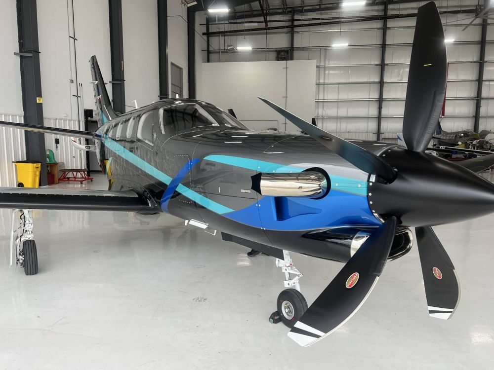

I'm not sure what happens from here. I'm a pro pilot flying a jet and helicopter, but that has changed. I was offered an opportunity that provides me with personal use of a new TBM 960; all expenses covered, up to 75 hours a year. 704's sole role was to provide transportation to our grandkids spread across the country. I'd rather travel in the TBM, which was delivered two days ago. I'm headed to school on it.
