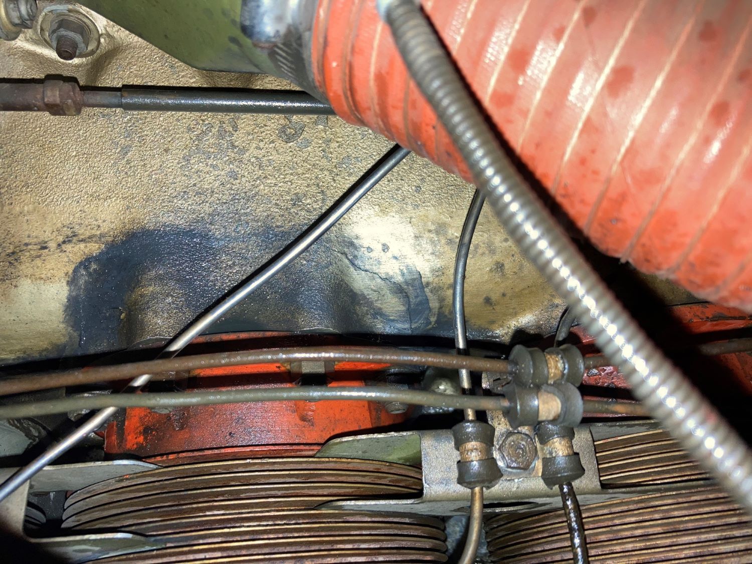

Jhogan0101 03-13-24 09:18 PM
Well after jamming many towels in many places and running up/checking the towels.
It seems that the leak is on pilot side between cylinder 1 and 3.
When flight air blows down it makes a real mess inside this side of engine.
Ive included a link to the drip.
Ive looked topside of the engine and do not see any leaking.
Could my cylinder be leaking between the heat fins?
Has anyone else seen this?
https://ibb.co/Fm0CJ3W
Kim Geyer 03-14-24 07:54 AM
It can leak there if the cylinder is cracked. I would remove that piece of baffle, pressurize the cylinder and soap check it for leaks. You may have a head fixing to separate from the barrel

Jhogan0101 03-14-24 06:48 PM
I removed the baffles today and good news looks like cylinder is not cracked.
Looks like the leaking is coming from the base of #3 and #1 cylinders.
Lots of wiggling when running.
Jhogan0101 03-20-24 02:57 PM
After retorquing the cylinder base nuts it looks like both the 1 and 3 cylinder have a small crack behind where the CHT probe is.
The leak on 3 is worse, drips once every 3 secs or so.
I will remove both and exchange w j&j or gibson.
