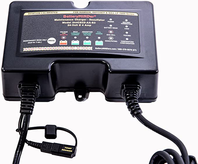

Can anyone recommend a good 24 volt battery maintainer?
I see tons of 12 volt battery maintainers out there, but not many 24 volt.
A maintainer stays connected to your battery 24/7/365 when the aircraft is not being used. They will extend the life of your battery, and help ensure your battery is ready to go when you pull your plane out for a flight.
Anybody using one they like?
edasmus 04-11-23 04:43 PM
“Battery Minder” 24 volt. Love it!
mshac 04-11-23 04:50 PM
2 Attachment(s)

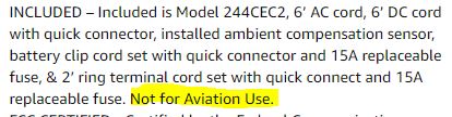

This one? https://www.amazon.com/dp/B01ERZ0CC4...language=en_US
Funny it says "aviation calibrated" right on the unit, but in the description it says "Not for aviation use" - WTF????
Attachment 2912
Attachment 2913
edasmus 04-11-23 05:08 PM
I’ve been using mine for 9 years now. I’m almost certain mine was for “aviation use” and specifically the Gill brand battery that I’ve been using forever. I’ve had good service with them so never felt the need to change…😊

However on my 182 have AGM battery and the $9 harbor freight job has maintained it for years without problem. To say, I have my doubts about these “aviation specific “ maintainers.
Frank Benvin 04-13-23 01:13 PM
It's a liability thing .Scared of being sued . I went to buy seal . As soon as I said it was for an airplane they told me company policy was not to sell it due to Liability If it failed and caused an accident they could be sued
