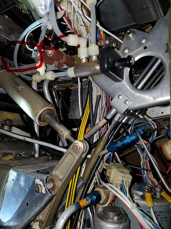

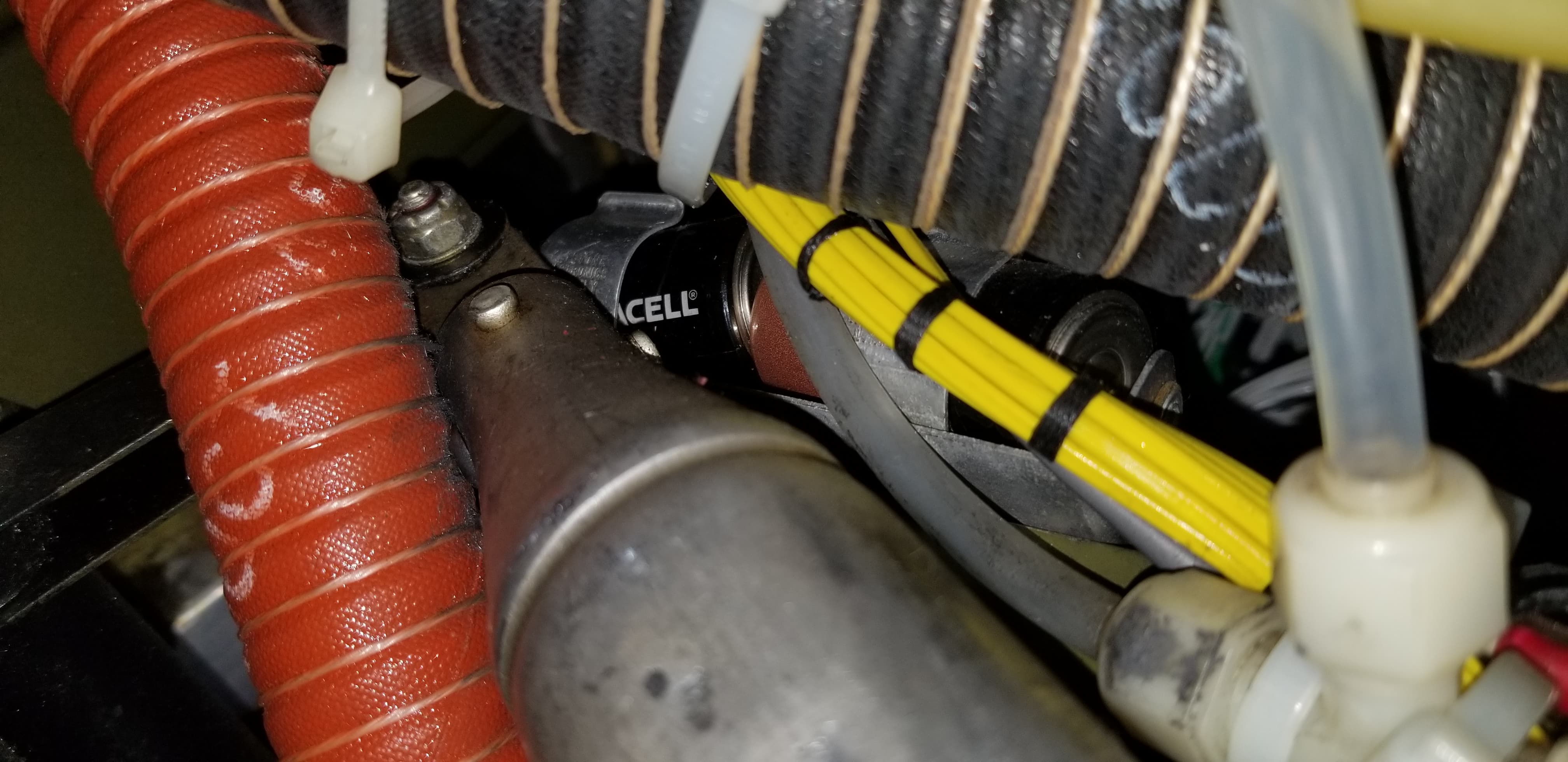

So I was under the pedestal working on my flap switch when I noticed some Duracell batteries. There are FOUR(4) "C" size batteries that will re-excite the alternator and make it produce power again after a total electrical system failure. With no aircraft battery power available, the alternators would be unable to begin making power after being taken offline without these batteries.
Mine were dated "BEST BY 2001" - LOL!!! They are fresh now. And be careful how they sit in the holder - its easy for them not to be in correct alignment, and therefore not have a complete circuit. If you look closely at the second pic, you'll see the batteries are slightly catawampus.
Photos were taken from the pilot's foot well, looking up. The plastic tubes are for the alternate static air source, which should help you locate the batteries.

To fix the mis-alignment of the batteries, see if you can get a zip tie to go around each of the lateral pairs to hold them down in position.

Mine has a cover over the batteries, I should be at the plane over the weekend so I will take a few photos. This holds the batteries in place.

Zip ties go across the hooks, then the cover goes on
